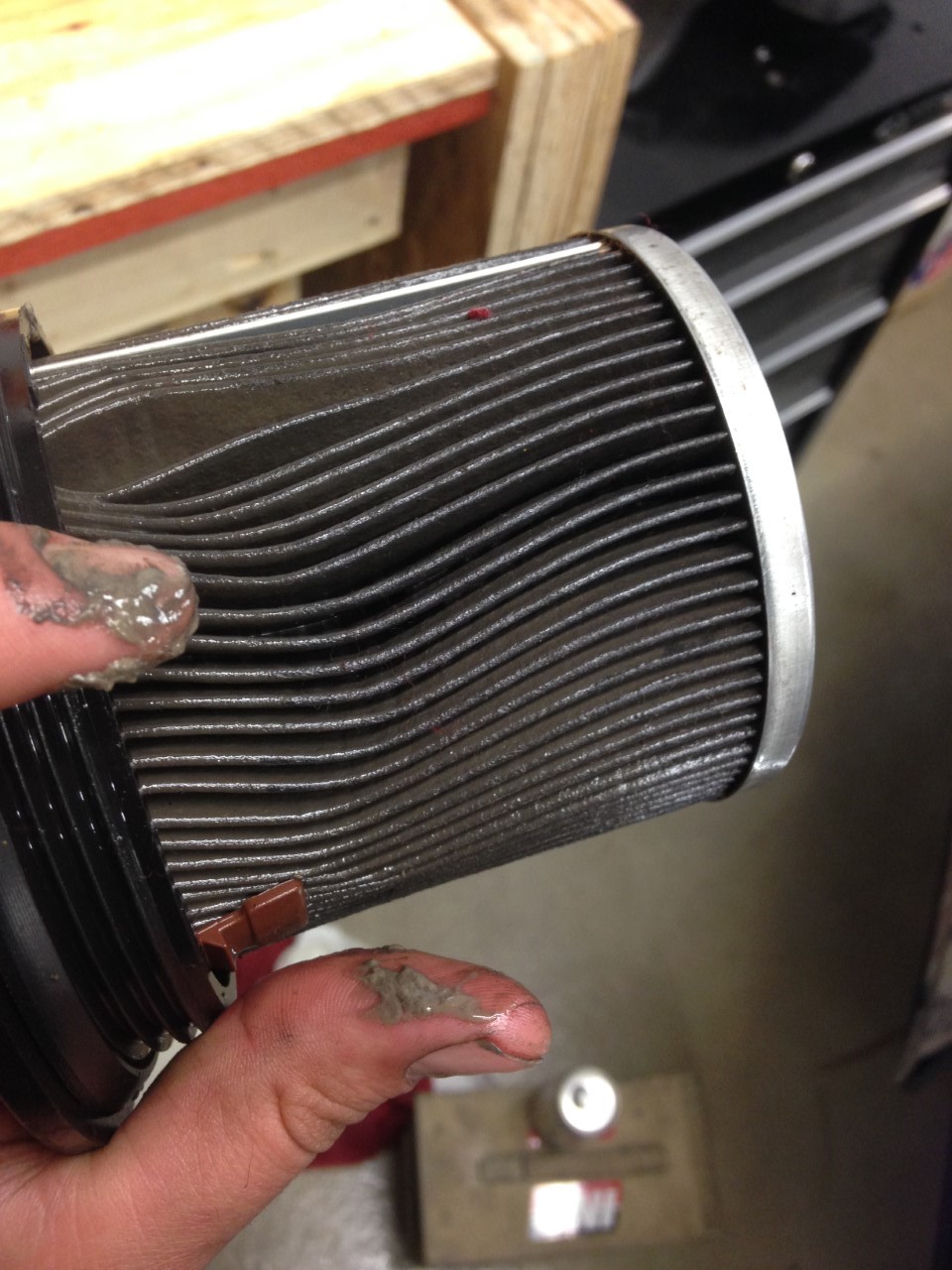

Replaced IPR and ICP pigtail this morning (locking tab was broke). Fuel filter had 6k miles on it, last filter did NOT look like this. Thoughts? Bad fuel? Crap in the tanks? I don't run the truck below a 1/4 tank and fill up at the same spot every week. Anyone know of any additives for the tanks if thats the case? Thanks:pint:

Injector o rings possibly. Did the "fuel" in the filter housing look like used motor oil? Looks like you may have some water or algae issues too.

If you need injector o rings i have a brand new set willl give you a good deal on... Its either oil or water or maybe both pretty nasty.
I drained the fuel bowl as I was taking the filter housing lid off so by the time I had it off it was less than half full. Definitely not used motor oil looking so I wasn't thinking O-rings but what I could see wasn't exactly clear either, almost had a milky hint to it. Never saw water in fuel light, kind of thinking possible algae issues? What to you think about power service Bio Kleen? What would your next step be? Thinking about throwing a filter in it/fresh fuel and maybe some of that Bio Kleen and keeping an eye on the filter from there.

I run the grey power service bottel alot. Grab a 911 bottel and throw it and a fresh filter in there and see how it looks in a tank.

Id drop the fuel tanks and clean all that crap out if it was my truck. Injectors are expensive, and its not too hard to drop the tanks.
