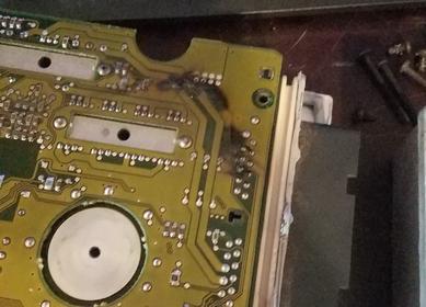

So IDM definitely fried. Old harness had fractures on VC connectors but nothing obvious or dangerous looking. Either way, have another IDM I'm picking up tomorrow, a new"er" wiring harness, im going to plug everything in and do some more voltage, resistance and continuity checks before I think of starting. Hopefully 3rd IDM is a charm. I'll post a pic of IDM damage as soon as I figure it out

IDM burn

So what's causing the idm to fry? You could have a pinched wire beneath one of the valve covers. I suppose you could ohm out the uvch's at the positive pins and other probe on ground and see if there is continuity. That would be a quick easy check to see if that's causing the idm's to burn, although I'd expect to see burns in the uvch connectors as well.
