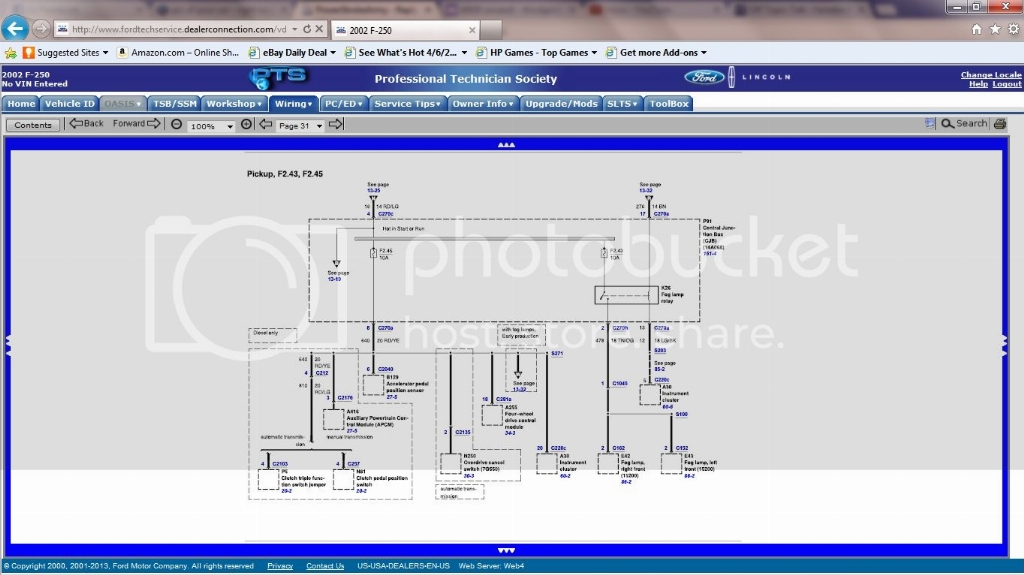

[QUOTE="thirdgenlxi, post: 647025, member: 10834"] You're gonna have to replace the shifter on the column.... the wire harness for the overdrive cancel switch rubs on the steering column and chafes the harness open, shorting it out and blowing fuse F2.45 (10A) in the central junction box located right below the steering column. Fuse F2.45 controls the O/D cancel switch, instrument cluster, 4x4 control module, and the accelerator pedal position sensor (no throttle response... they'll idle only). New shifter, new fuse and you'll be good to go :thumbup: [ATTACH=full]107839[/ATTACH] [/QUOTE]
