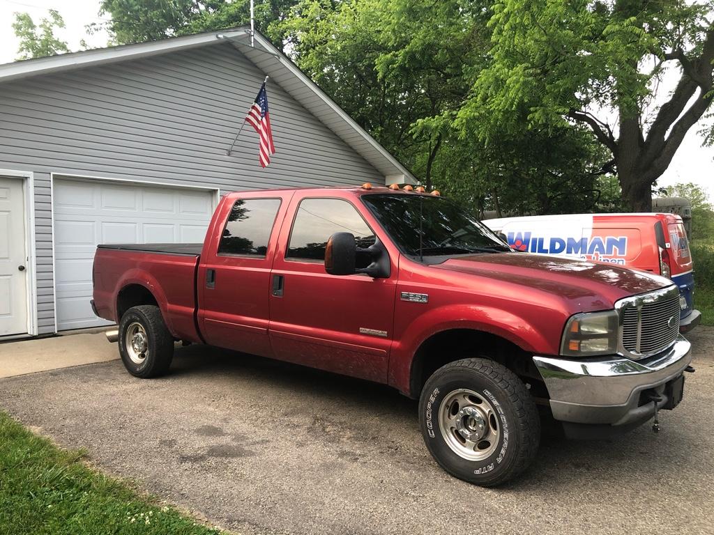

Here is the first time I had seen it in 8 years sitting on the corner:
Then one sitting in my driveway after my wife had surprised me:
One of the owners since I sold it out on these fender flares which will be disappearing soon, but I’m pretty sure they are covering up some bad bed rust. The truck also came with some OEM 17’s so I threw them on to see how they looked.
Not terrible, but I’d still like to find some Platinum 20’s for her.
Truck also has a ton of clear coat peel on the hood and roof, so eventually, once I have all the rust free parts I’m tracking down, the truck will be repainted.

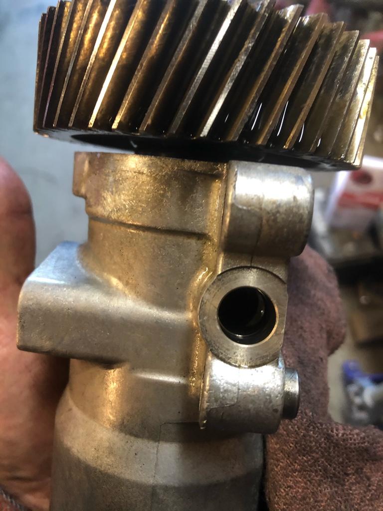

Loaded a tune that came with the truck on an SCT X4 and the truck ran great! Plenty of power, low smoke, just made the truck much more fun to drive. Move forward a couple of days, go out to start the truck and have a super long crank, like almost 60 seconds before it even tries to fire. I returned the truck to stock and the issue persisted. I also now have the oil gauge dropping to zero at idle.
Pulled the filter and put a new Ford filter in as well as replaced the anti-drain back valve at the bottom of the filter housing. No change. Pulled the plug out of the front cover behind the balancer. No debris and the plunger came out freely.

I take it that this is a 6.0?
If it is, your extended crank/gauge dropping at idle is probably the ball blown out of the side of the hpop.
I’ve seen that multiple times on 03-04 trucks. They have 2-5 psi low pressure oil pressure at idle when that happens and iirc it takes 7-10 psi to trip the low pressure switch for the dash gauge.

Thanks for your reply Zeb! Yes this is a 6.0. I’m trying to rule out everything before pulling the HPOP, but I’m figuring this is the case as well.

Damn it zeb, beat me to it.
I agree with him, there aint much on an 03-early 04 that will mess with the hpop system. Mostly pumps, icp sensors, and injectors. With it starting, its most likely not an injectir top o ring blown out, which leads down to the hpop/icp sensor. Id do the sensor and pigtail while youre back there, as it will be a **** load easier. And as zeb had put in a post awhile back, use a late style sensor, as they dont seem to fail as often. At least according to him, I havent tried it yet. Lol.

Not a ton going on at the moment. Tore the truck down over the winter and found that the check ball had in fact blown out of the pump.
Tapped and plugged then reinstalled with all new gaskets. Truck runs great! Haven’t found the little ball yet either...

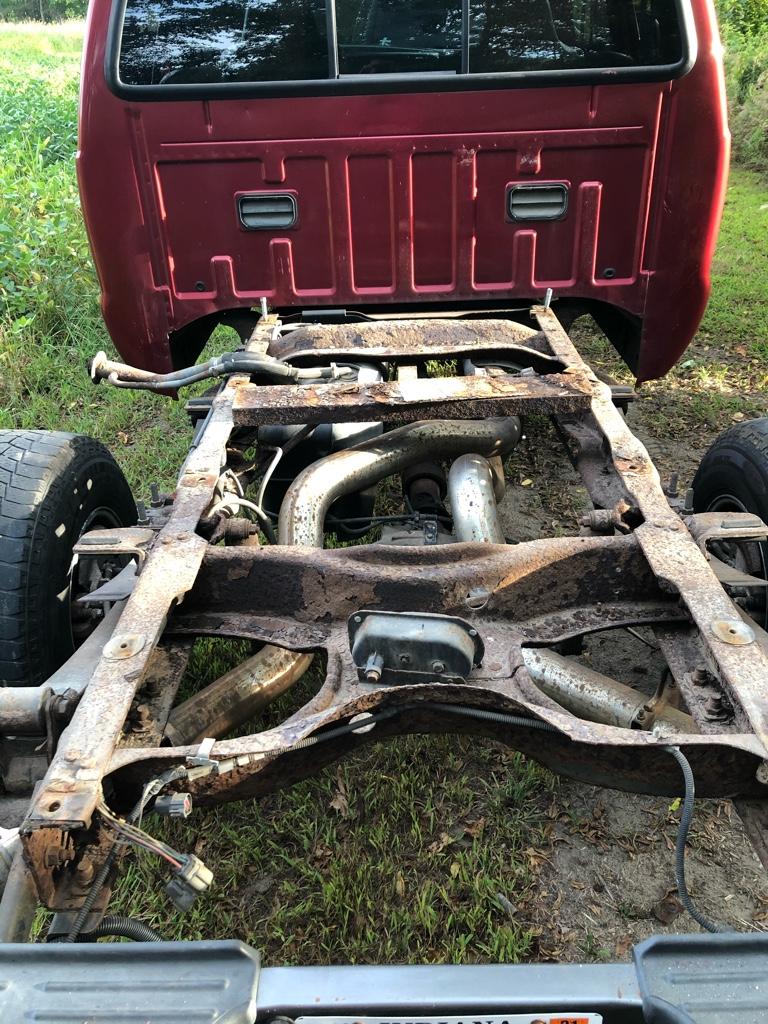

Pulled the flares and they were indeed covering up rust. Not as bad as I’ve seen, but more than I’d like, more about that later.

And lastly, to bring us up to date, I tracked down a rust free bed in the same color as my truck!! Super excited, needs a little bit of work, but it will get me by until I’m ready to repaint the entire truck.

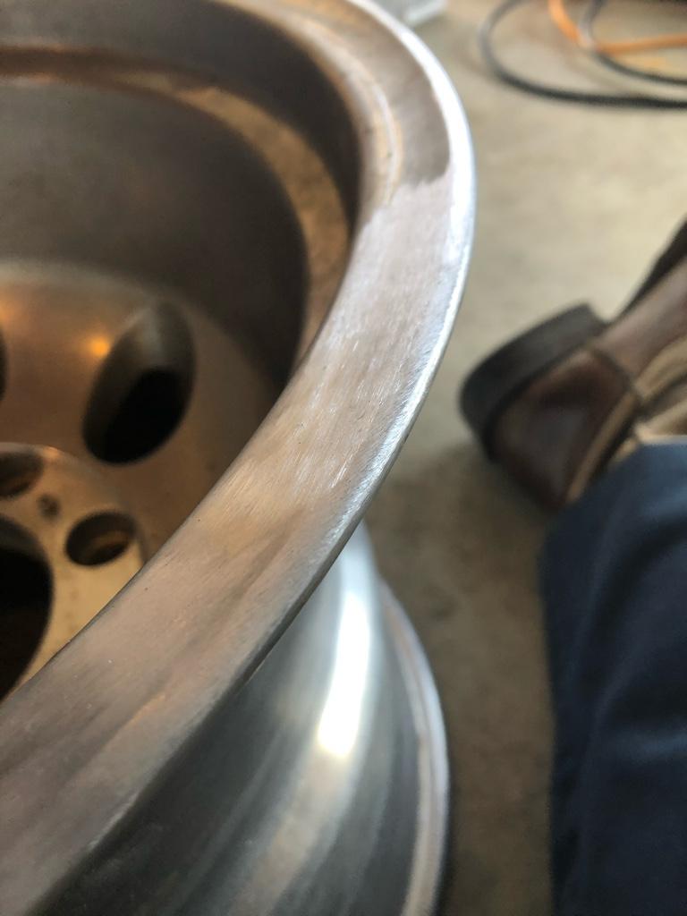

Added another piece to the puzzle yesterday. Picked these wheels up a couple months ago, pretty rough, had some deep curb rash, but picked them up pretty reasonable.
But cleaned up pretty well
Then picked up a set of 305/70/16 tires, had the wheels polished, and mounted them up. Turned out pretty good! Slight difference in size from stock wheels on 265/75/16.

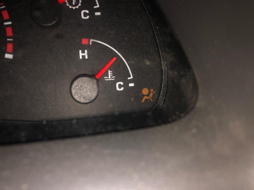

Had an airbag light on, horn didn’t work, neither did the cruise control. Bought a clock spring and replaced it yesterday. All functions work again!

I have an airbag light on (code 27) and my cruise does not work anymore (on button fault code {do not remember the specific code}). Clock spring is not going to fix my issues, and the code 27 is a bulb that is integral to the passenger airbag on/off switch...... $.37 bulb
Need to replace a $70 switch
