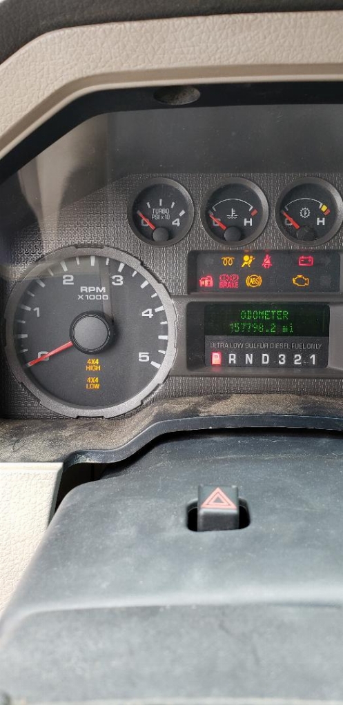

I did a 4wd conversion on a customers 2008 f450 everything works it's a manual floor shift 4wd.I can't get the 4wd indicators to work on dash I switched the transmission harness for the 4wd harness.If I use my IDS I can go in and do a cluster test and make the lights turn on high and low for 4wd but they won't work when you move shifter.I believe the cluster has to be programmed so it knows it has 4wd the IDS only programs to vin # on truck so I don't know if I need to take the cluster and stick it in a 4wd truck that has floor shift and program it to that vin #.To make the 4wd light work or if I can send the cluster out to be programmed for 4wd.
I even ohmd out the wires to switch on transfer case for 4wd switch to cluster plug it all works so I think it's in the programming I even tried another cluster from a buddy the 4wd lights worked.

It is programming. You can change the code with FORScan

I looked up the module built data or as built on ford website I found the same truck I have but 4wd manual floor shift and saved codes for the cluster so I'm going to enter the codes for the 4wd truck.I looked at several different trucks f-450 and f-550 with manual 4wd they all had the same coding for the cluster so hopefully it will work.I then looked up other trucks f-250 f-350 with manual floor shift the coding was different so I'm guessing the f-450 f-550 with manual floor shift 4wd shares the same coding for the cluster.

Got the lights to work changed thr coding in cluster had to buy the license to access cluster.Lights now work thanks for the info for the software.
