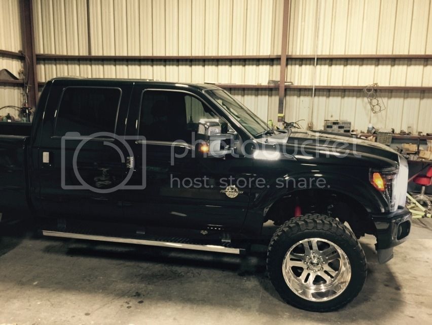

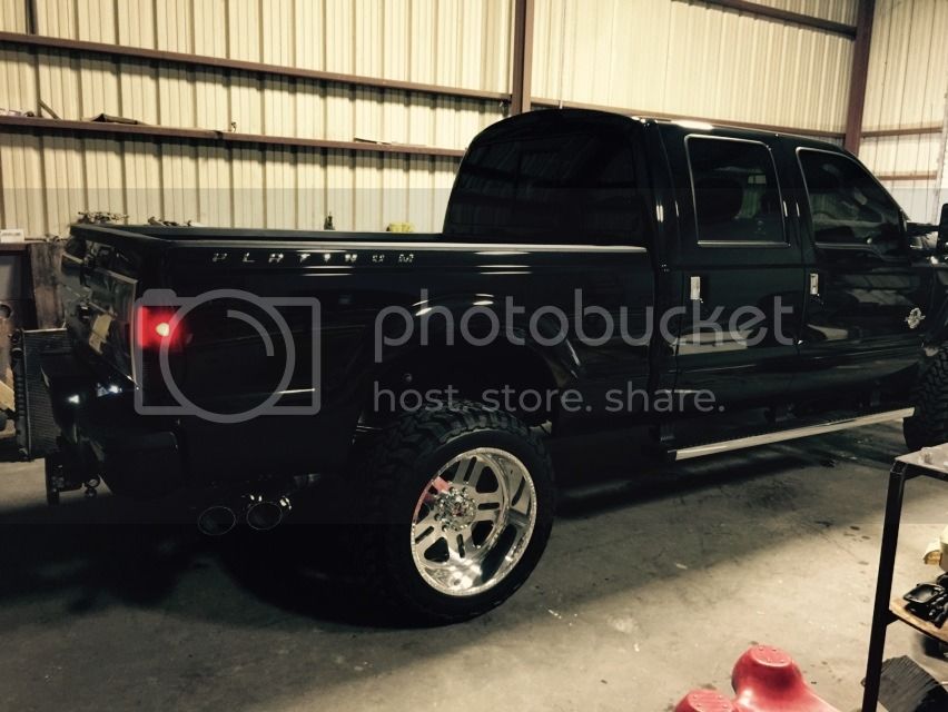

I went with a 3.5" and 22x12" with a -40 offset and only had to trim a 1"x1" piece of the inner bumper brackets and cut the inner fender well liner on one side a tad. Like 2" by 4". It's weirdbecause one sidecalready comes trimmed and the other just needs to bevtrimmed yhe same.
What offset are you getting?

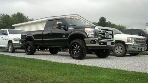

I have 20x10s with -12 offset and 35x12.50 and had to trim a little off the fender liner so it wouldn't rub offroad...normal driving was fine with that wheel/tire combo though
That's a beautiful truck!
