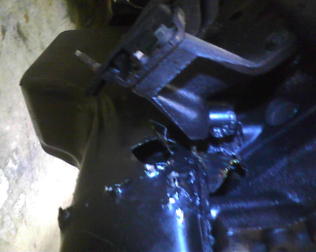

Here is a picture of the escape hatch my rod decide to use... somewhat led to believe by the destruction it was a piston/rod failure both... Both sides of pan and block were breached couple times... sorry picture is sideways

It was not ment in a bad way. My rod also went and cracked the block. PMR's are a crap shoot either way you look at it once you add extra stress to them.

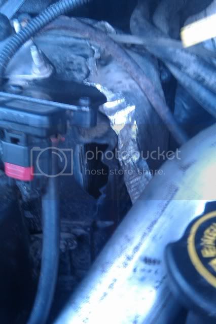

Average...jody said u blew a hole in your heater box when the boot blew
If so let me know I have one u can have

Yeah thanks bud, I have some fiberglass I'm just gonna fix it with, not worth the effort of ripping it all apart again.
There might have been a little force involved when it shot off haha :cursing:
