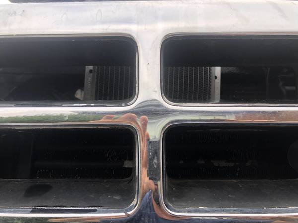

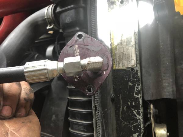

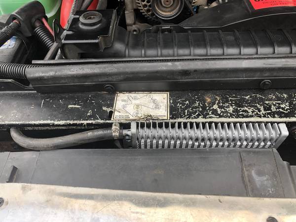

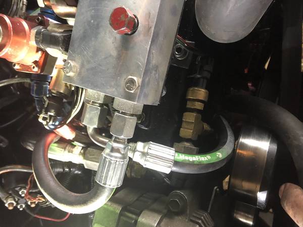

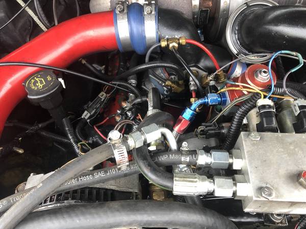

I’m doing a “face lift” on my truck. New grill support and headlights. While I had everything off the front I rigged up the cooler. Right behind the intercooler and in front of the AC condenser. I’ll get some pics. Still need a fitting to finish the lines.

Installed, run it and see if it makes a difference
