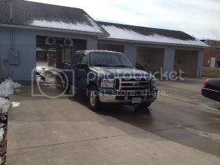

So here's what the 05 looks like as it sets right now. I'm looking at over the next year getting it where I want it. I'm running stock wheels this time and wrapping them with 420s, but I'm looking to go up to a 20" wheel hopefully. What would look go as far as 20s go? I'd also like to lay it out a little more level, and don't know where to start. Can I just pull a block or a leaf from the rear to get it level or somewhere closer to level? Harley lights are next on the easy list and it'll have new mirrors as of Monday. Pics of lowered/leveled trucks would be great. I just don't what direction to go with it yet.

Stupid phone didn't copy what it was supposed to. Here it is:

Guess it should've been specified that it'll also get a set of studs and and some other goodies this summer. Probably a powermax, 155's, and a regulated return. Didn't really think of it at first because I want to start with cheaper upgrades like wheels and tires and mirrors and whatever other cosmetic upgrades I feel like while I bank money for the big part of it. I don't need an 800 horse street truck so the biggest majority of "my" build will be making the truck look like I want it to.

Good deal, I wasn't even sure about how the rear suspension was set up and it's only 18 degrees at the moment. I'll have to look into a shackle kit and crawl around under it when it's warmer. I'd like to build a decent set of traction bars eventually too, I just want the suspension done before hand so I'm not doing the same thing twice.

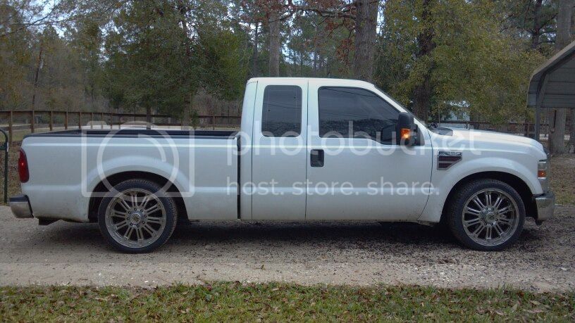

Cody that looks slick. I just picked up an ex/sb 2wd. I'd like that stance with a set of factory 08 rims
What did you do for lowering it suspension wise ?

2000 2wd F250, stock front, rear has shackles and spring clamps to bring it down a tad, eventually will do the DJM 3/5, stock 08+ 20s with 285/55R20s and 2" spacers to even up the track width.

That's sharp, lays out real nice. What did you use to drop it? I want to be somewhere close to that I think rather than just leveled.
I used a DJM 3/5 kit, install wasnt bad took a buddy and I a day to do it in his driveway.
