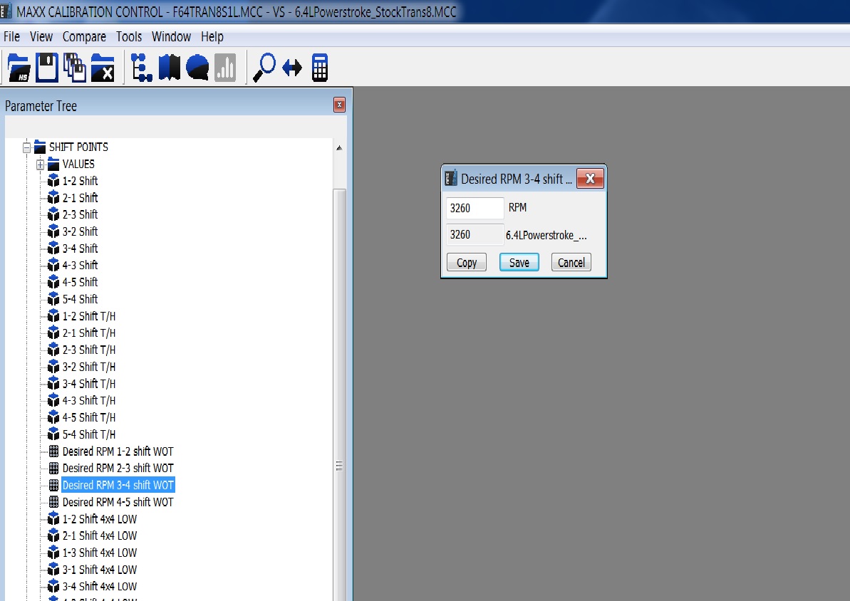

Hi everyone, I have a 2010 f250 with a minimaxx running hd 300 with s1l shifting that I modified with mcc. I didn't like that in tow haul mode the truck shifts from 3rd to 4th at 3800-3900 rpms at wot. I lowered the shift point in mcc a few mph but it didn't seem to do anything. All the other shifts seem to change just fine. Also the speed values on the 3-4 tow mode table seem to be way off. It says that at 10 percent throttle it shifts at 23 mph but it really shifts at 40 mph.

Well I've done some more testing and it seems that any changes I make to the 3-4 shift in tow haul mode don't affect the shifting.

on my truck the shift speeds in the tables are about 75 percent of the speed the truck actually shifts at. For example, the table says to shift from 4 to 5 at 50 but it really shifts at 66. This seems true for all tables except the 3-4 tow mode table. I'll try exporting the easy tune tonight but it might be a while before I test anything. Maybe this weekend.

another question... are you modifying that 3-4 shift point at all?
I have noticed with MCC, sometimes you'll export a tune and it'll have a value in a cell that is impossible to manually input. A lot of the trans stuff, I'm not hip to, so if the OEM tune or export has some odd ball negative value and if I try to replicate it and it enters a zero, I will make a note of it, and re-export and not touch that/those cells so the values remain the same as the export.
I guess what I'm wondering is: if you don't touch that last number for the WOT shift point, does it still drag out to 3800/3900?
if not, I would say there's a glitch in MCC. possibly uninstall/re-download the software?
I would contact H&S about it for sure. They'll definitely want to get it ironed out

The 3-4 shift in tow haul mode has always been around 3900 rpms at wot. When I tried to change it, I found that no matter what I changed in the tables that shift would not be effected at any throttle position
