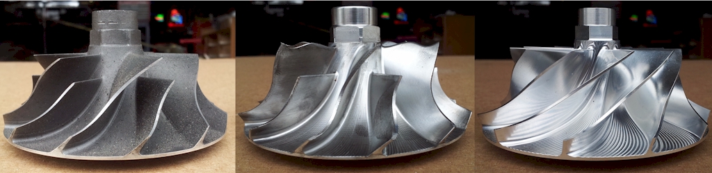

From Bill's thread on the new wheel, here's what they are supposed to look like.
Left is OEM, far right is WW2.

Did the bore fit well? I can't believe the pilot bore worked out, lol. Imagine if it was a sloppy fit and didn't center.... that would get a bit out of whack in the 50+ thousand rpm range.
Whatever charger that wheel is for, it's a standard rotation charger.
