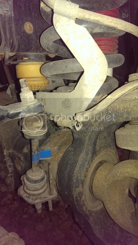

On my 14 F350, yesterday, my truck acted like it would not go into 4x4, though the light on the dash said it was. I looked around and found what I believe is the vacuum line for the hub broke into. What would be the best way to fix it?

replied some place else but a barbed coupler fitting will work fine at that location
just dig out the broken parts from the lines and put the barbed fitting inside that retainer

From his pic it's very easy to see the problem, but giving him a heads up issues will probably continue to arise with that system.
