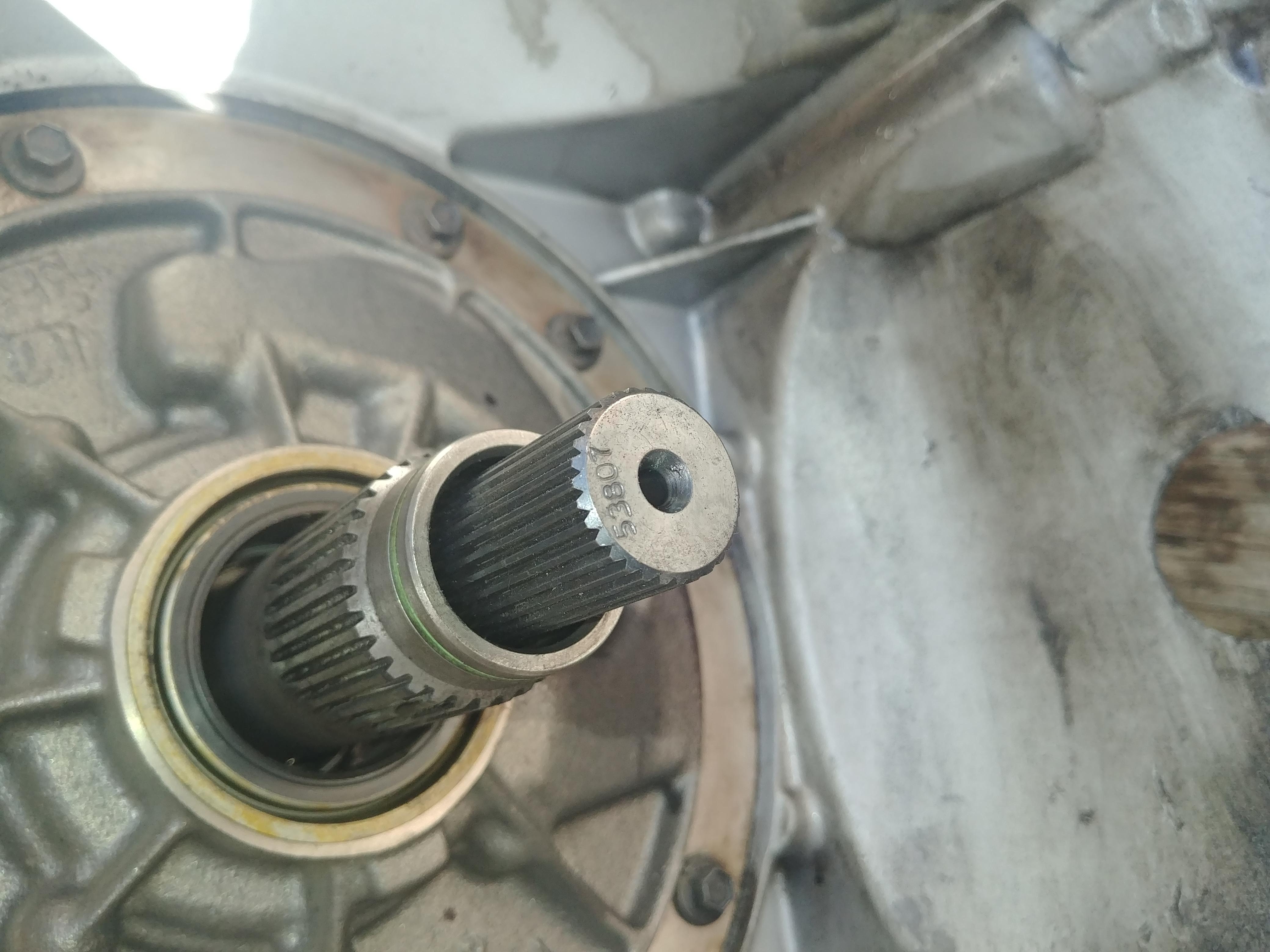

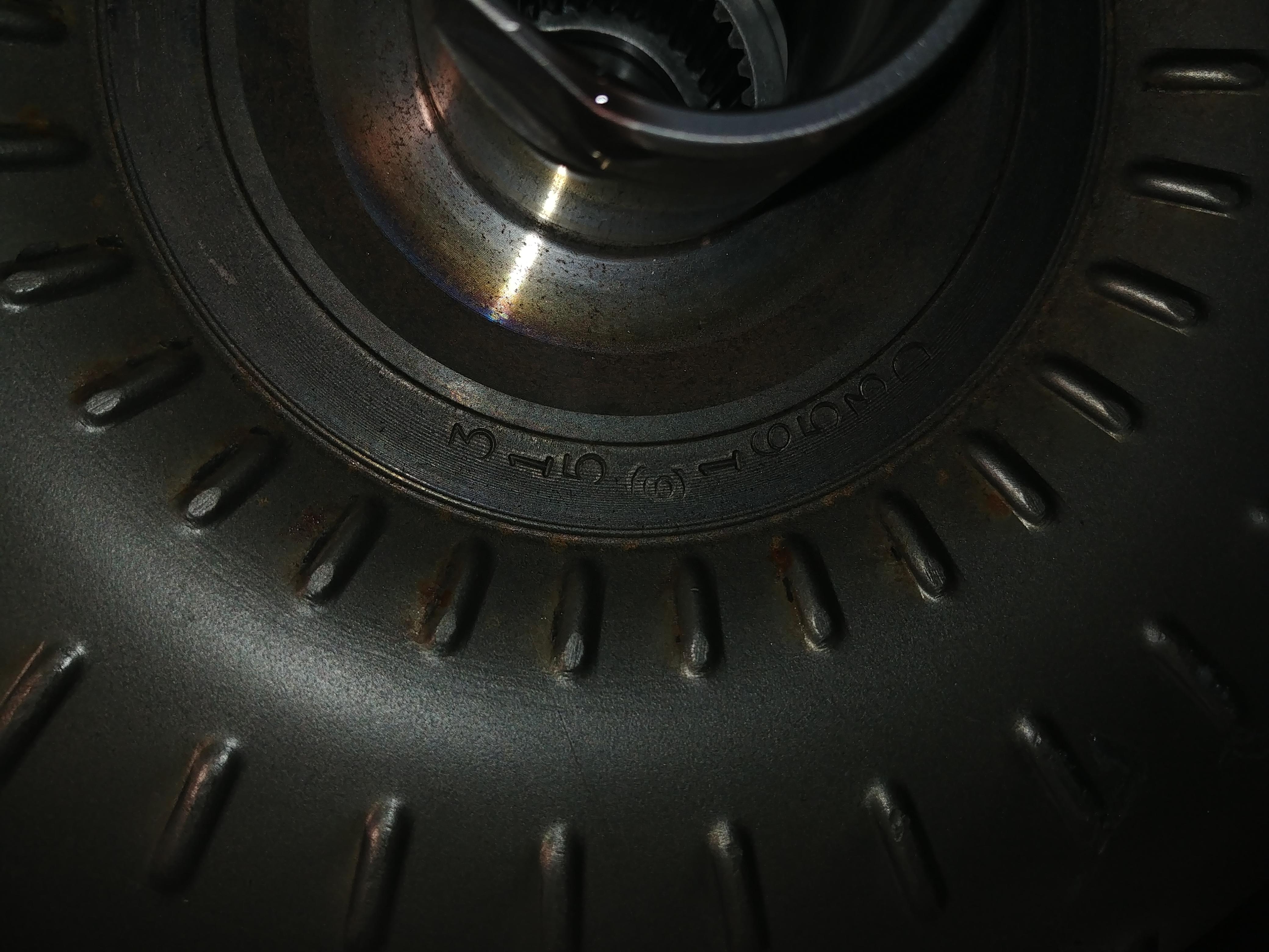

Thought I had a broken input shaft. The truck lost all forward, reverse and park. Pulled the trans and the input shaft is good. Without pulling the input shaft out the input shaft will spin not moving the output? Is it a broken intermediate?
Also this trans in supposed to be a full billet build from mpd. Is there any way to verify that? It looks like the input shaft is billet. I'll post a couple of pics with the what is stamped on the input and converter if that helps.

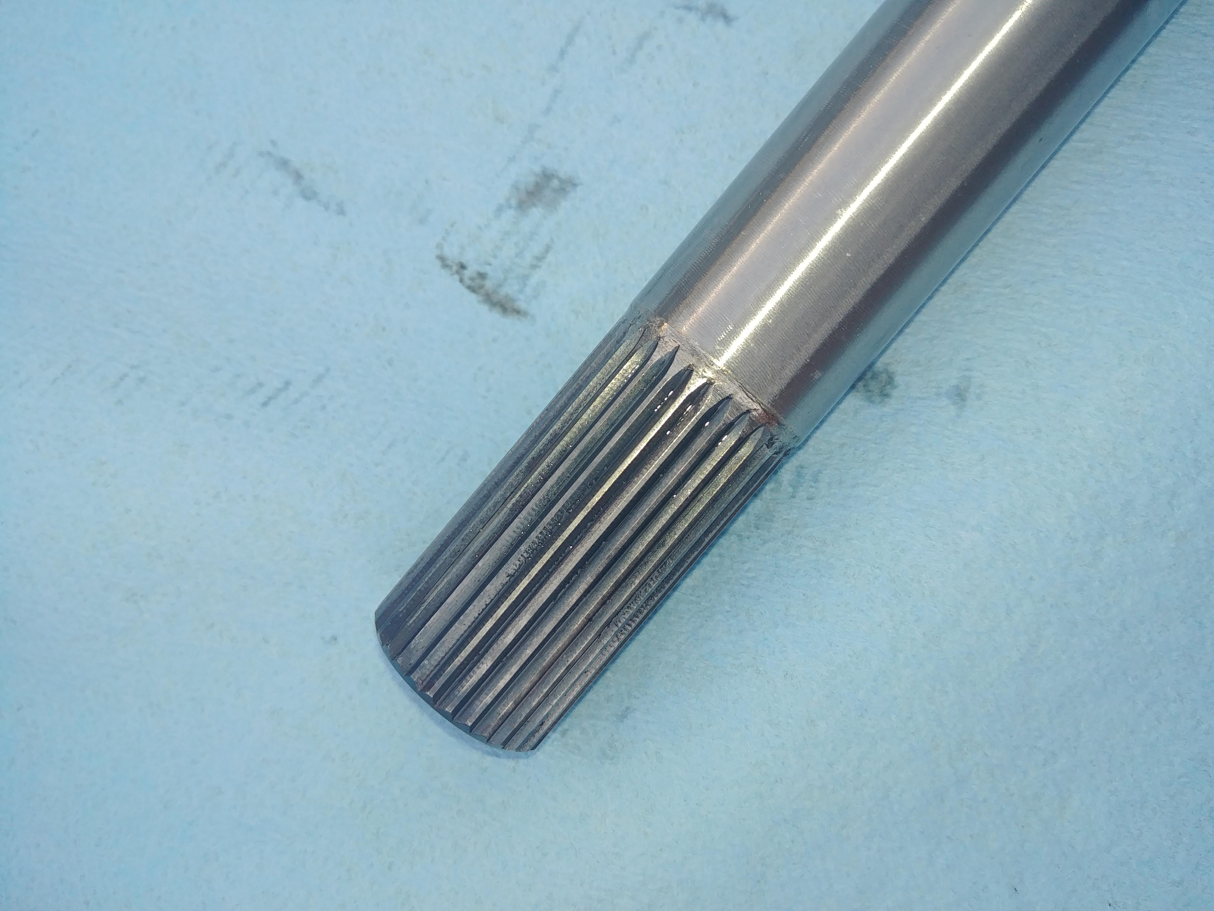

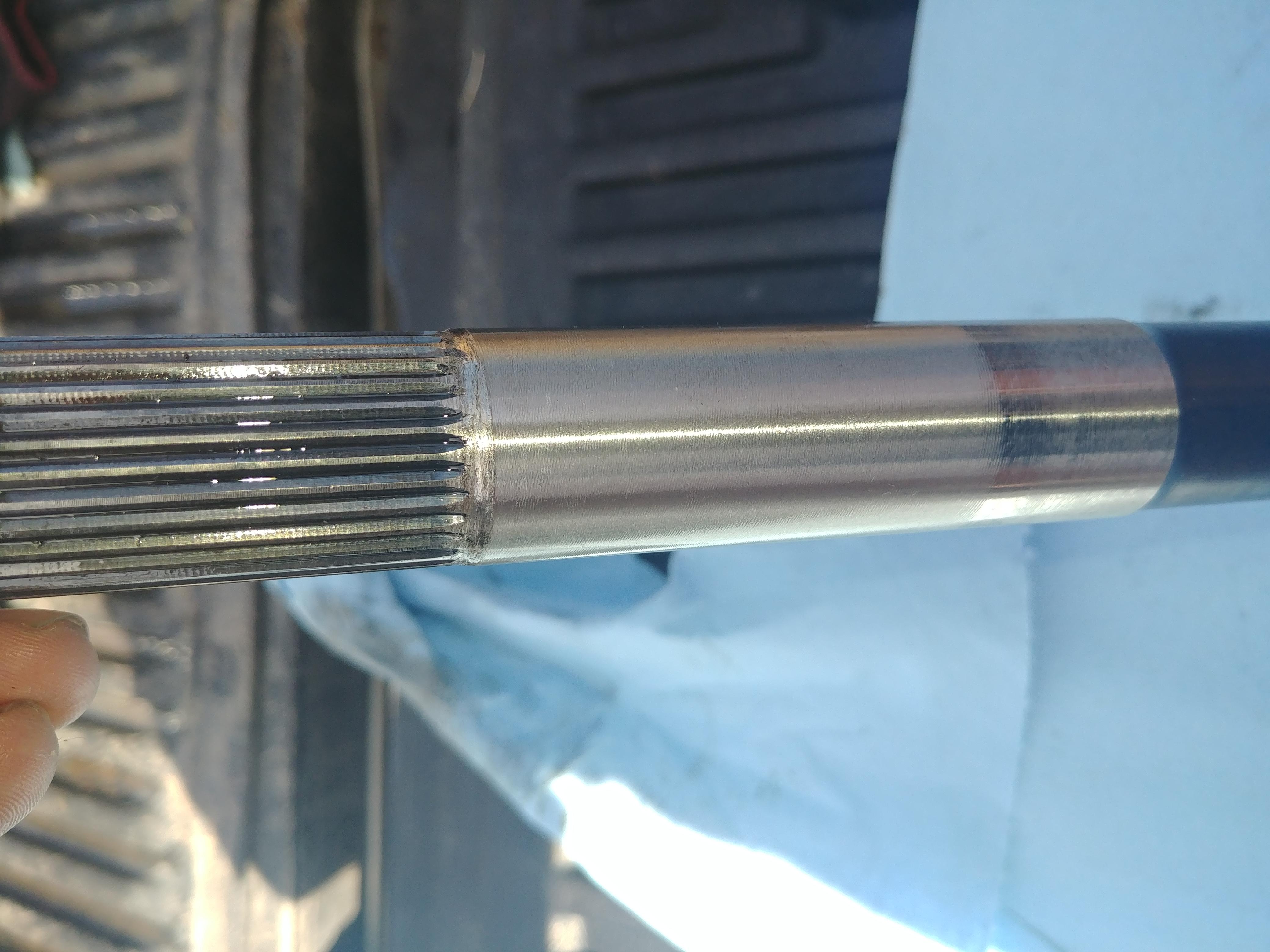

After further inspection the input shaft is stripped towards the front of the back splines.
The transfer case was the first thing that I checked as I thought I blew the rear end. I put it in 4x4 and the truck still spins all 4

I can not imagine that is or will Be the only failure. Going back together I would for sure use a aermet shaft.
sootie
Oct 3, 2012
11,853
39
trans needs a full tear down. the input shaft is not what is causing your issue.
curtis270
May 20, 2019
75
what he said. I broke my intermediate in my last truck park was the only thing I had.
