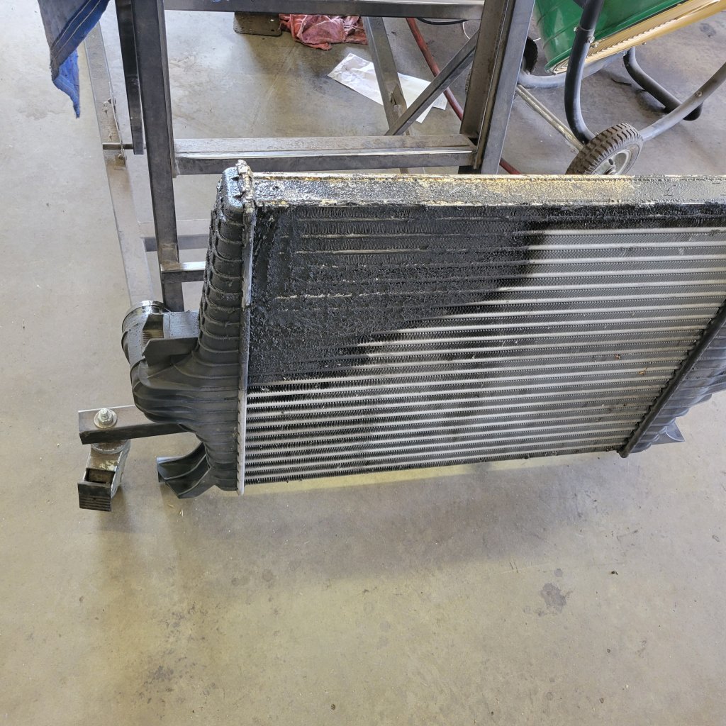

Concern is I've got 20 psi charging this cooler and it's slightly bigger than a pinhole leak. Gotta fix what's broken first..
Could be something where it’s getting hot and expanding as well, and with it on the ground it’s cold enough to only be a small leak, but once it’s up to temp and the intercooler is heat soaked, everything expands and it gets bigger. Hopefully that’s all it is, and it’ll be out of your hair
