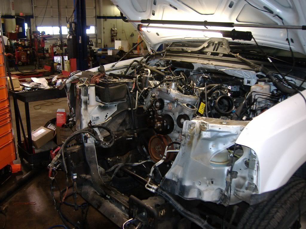

Pull turbo, intake, FICM, up pipes, degas bottle, heater case makes it nice but isn't necessary. Use the shortest chain you possibly can to avoid catching the rear lifting bracket on the cowl repeatedly.
If not pulling the cab, I take the bumper, cooling stack, upper radiator support crossmember, and everything all out to make it easier to get the engine out the front.
Kind of like this.
