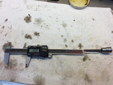

SnapOn part number S6340E
If you want to build your own, you need 2” of shaft below the head.

I have a generic one (doesn’t cost much if I don’t get it back) that I loan guys that are doing injectors. I swap it for a new one every couple sets. I just measured it and the shaft is 1.750” long and the head is very close to the top of the injector.
