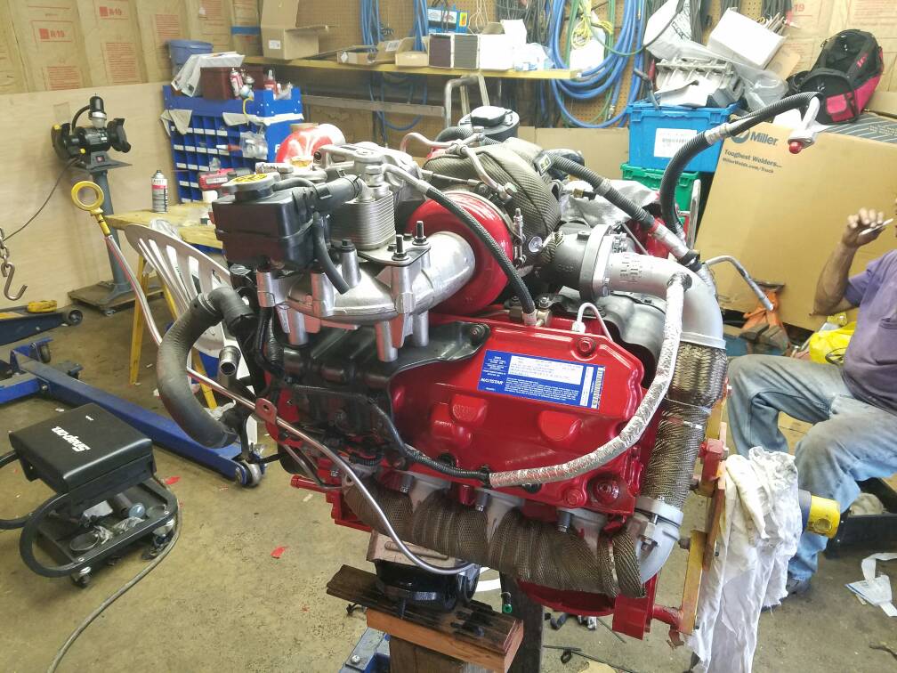

Welcome . The spacers in my picture are OEM, so you should be set if you go with a 40MM bolt.
