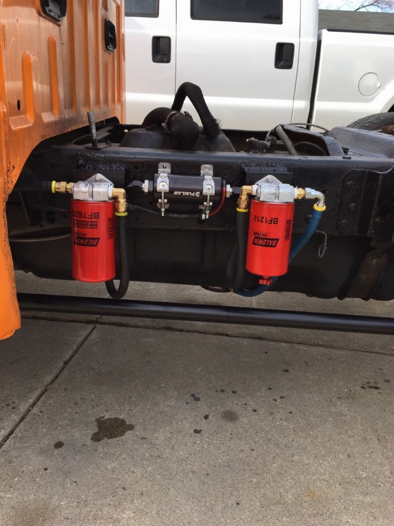

I built this setup for my truck for around what a fass 220 kit costs,It was much quieter too. Took it on a few long 6+ hour trips and never had an issue, Still going strong.
You can build your own or buy a Marty's fuel system, he has complete kits for the entire fuel system.

Nice setup six_slow. What made you go with that over a fass or air dog? Where did you buy the filter housing and what model?

The fass and airdog are fundamentally the same thing, I got a fass because I listened to the Internet and everyone said how they were so much better than ad.
The fass was the loudest pump I've ever heard, thing sounded like it was crushing rocks and just wailed like a sob.
The pump is a 41401-1
Filter bases were wix 24770
The filter is a Baldwin bf7633
The ws is a bf1212

The fass and airdog are pretty reliable pumps when used for what they were designed to do, but they crank the pressure up for 6.0 systems and they just don't work out.

I would highly recommend a sump, beans diesel is my personal favorite. The only thing that will kill a fuel lab is if it's forced to suck fuel from a tiny straw. Also I found I needed at least a 3/8 return line, with the fuel lab I wasn't able to properly regulate pressure because the stock return lines were restrictive
