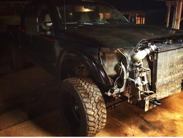

I was browsing the forums when a thread came up. He asked what parts he needed and what modifactions are needed to get it mounted and converted. I told him perfect timing LOL. So I went forward and made this thread for future reference as a "guide".
This is not the best picture I'll try to get more up..
