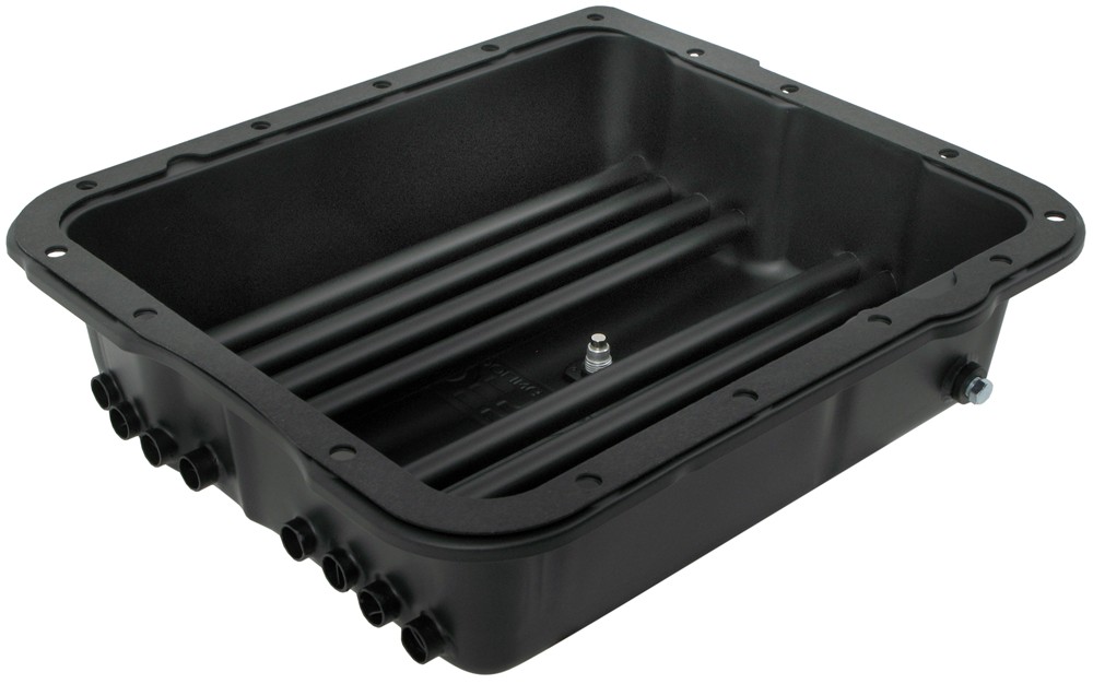

I did the late 08 pan swap and instead of using the late model pan to accommodate the new style filter I used the Derale pan with the OEM reusable gasket I left the toilet paper one in place and made a label for it noting the new style filter in the pan
incase I ever sold it or got to old to remember LOL
i like having the better filtration all the time that the new style provides
Damn that is a deep pan! http://www.ebay.com/itm/New-Derale-...r_Truck_Parts_Accessories&hash=item3cd97edada
I think im just going to go with the stock 6.4 pan. I can get it for $60 but that^ is a nice pan.

Amazon had the Derale fir 130 ish IIRC
definitely not needed
I am in agreement with the school of thought that more fluid is better
not all agree but I am not open to discussion LOL
if the new pan does not come with a Gasket just use your old one it has crush prevention inserts and is OEM approved as reusable

swinky

More fluid will simply take longer to heat up and longer to cool down. I think the main benefit is that you will have a lower concentration of contamination with more fluid.

usually by adding more fluid, you're putting on a (larger) aftermarket pan which in theory would give you more surface area to help dissipate heat from the fluid? I could be totally wrong, I'm not an expert, just strikes me as logical.

It makes sense until you understand how the whole system works. Then it falls apart because it is only wishful thinking, it doesn't work in actual practice.
The main thing that keeps a pan from dissipating heat is that there is very little fluid movement near the inside surface of the pan. In fluid dynamics it's called a boundary layer. This is a layer of fluid that just stays in place. It acts as an insulator. That fluid will cool off some, but not very much. It keeps the really hot fluid from hitting the pan so it can't ever cool.
The other thing that keeps the pan from dissipating heat is the hot air all around the pan. Have you ever measured the air temperature around the pan? I have. It's hot. You have the hot air coming from the engine compartment, including the air that has passed through the radiator. Plus the exhaust is nearby radiating a lot of heat. When the air all around the pan is hot, how will that cool the pan? The answer is that it can't. If you want to cool the ATF get a better cooler. The pan is not the way to do it.

I know I said I wouldn't debate the larger pan / more fluid theories but this is different LOL
Mark's boundry layer is the best explanation I have ever heard IMHO
interesting the Derale pan puts tubes through the pan I wonder how well these work
at skirting the "boundary layer "
but I agree I wouldn't add an expensive pan and count on a noticeable cooling benefit
however moving down the road at a decent speed I would expect the airflow around the pan to be a lower temp than the internal fluid temps that may all change when you hit a steep grade and are towing ?

interesting the Derale pan puts tubes through the pan I wonder how well these work at skirting the "boundary layer "
It won't make any difference on the boundary layer. And it won't make any difference on the hot air all around the pan.
Remember what I said about wishful thinking?
On the other hand, it doesn't cost me anything if you buy one of these pans.
