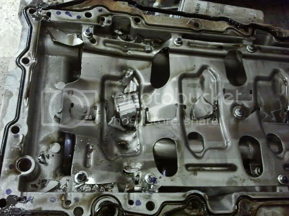

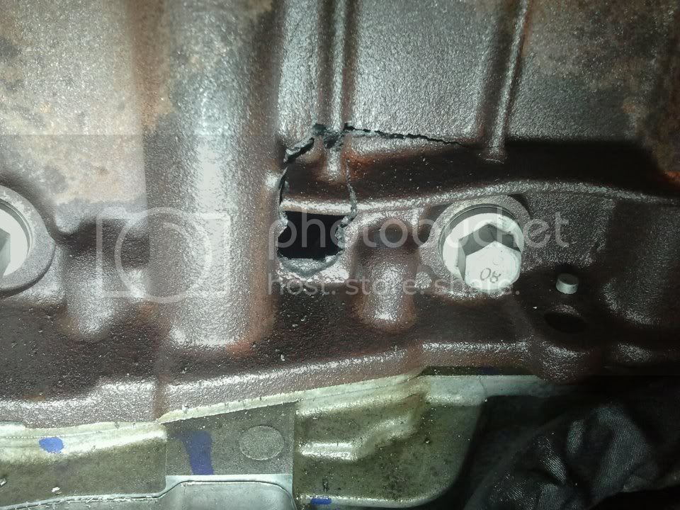

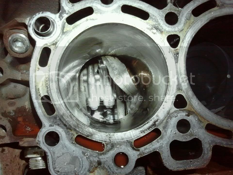

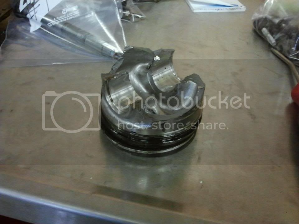

Well, I talked to a friend of mine today who told me about a 6.7 with bent rods and a windowed block. Truck was running Industrial's twin kit and a set of 100hp injectors.... This was the result.

Hmm so the 6.7 doesn't like powa.
Im on the fence about it. The truck was running a host of aftermarket parts with no seat time by a tuner. Just a standard canned tune. Maybe a custom file makes the difference, maybe it doesn't.... its all speculation.
Notice the wrist pin?

Forged or not they look to be a pretty small rod. I dont think this motor failed catastrophically just due to the level of power the truck is at... I bet there is a little gremlin somewhere. Either way, I dont think its anywhere near as stout as a 6.4.

LoL what wrist pin ? Is it a magic trick ?
