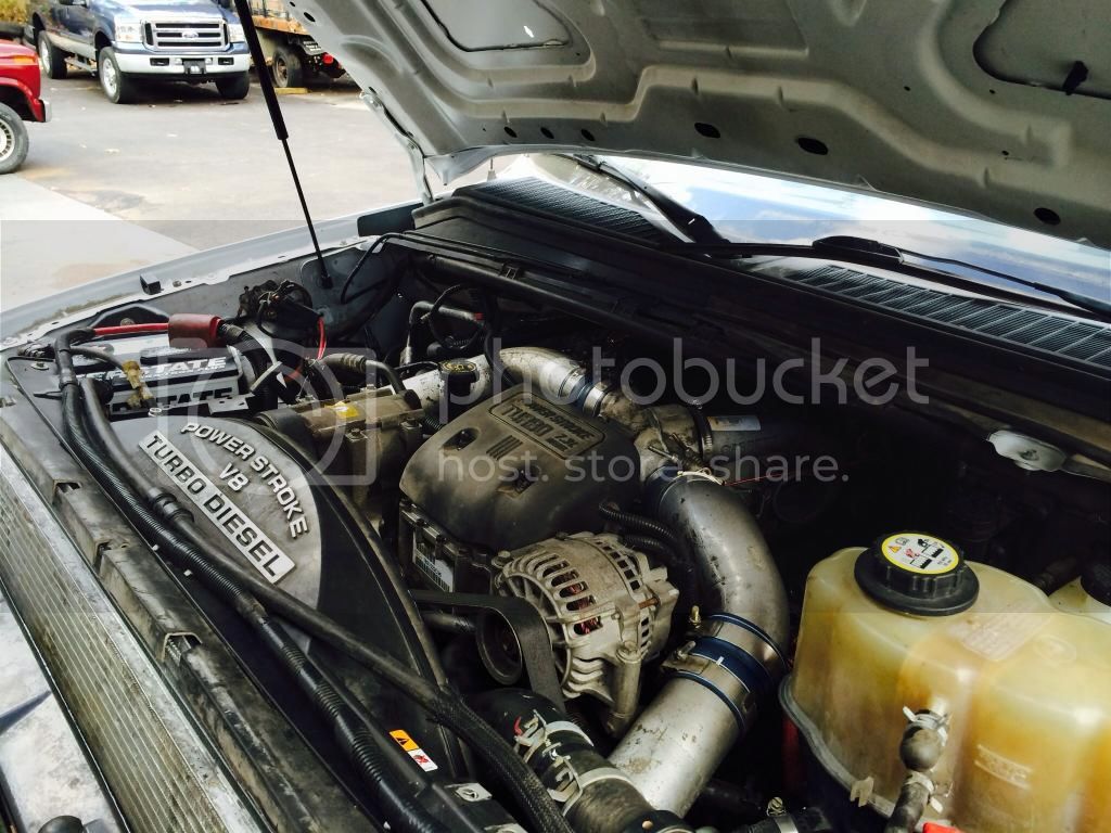

Where was that truck located? We have swapped several 04-07 6.0s to 7.3s. It works very well for my clientele and gives them some of the newer features too.
co04cobra
May 21, 2011
3,003
10
WV
Here is a 08 we are finishing up swapping a 7.3 in.
Still a little dirty but you get the idea. Craigs 6.7 into the 99 looks sweet..!
I'm all for any of these swaps as long as you stick with a PSD. :ford:
