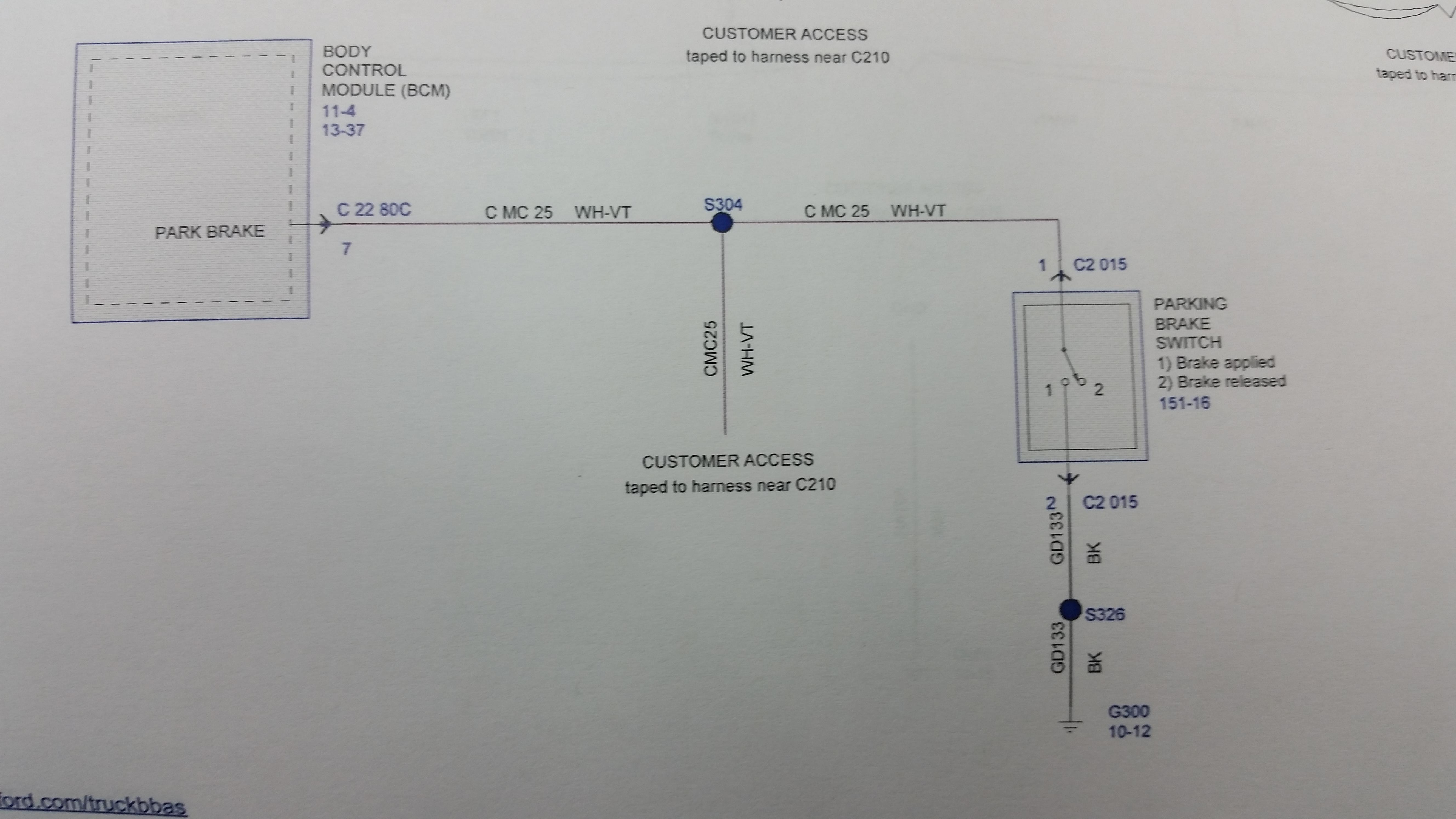

Can't figure out why one wants to use the SEIC and/or BCP feature without setting the E-Brake. I get it that the BCM needs to see the E-Brake ground input if the truck needs to move in PTO mode.

You do know that the white/violet wire is already tapped into the E-brake circuit. All you have to do is press down on the E-brake and the BCM already knows the white/violet wire is grounded. No need for any relays or extra wires.

Yes, but the point of my video was to be able to use SEIC without pressing down the e-brake at all. That's why the relay was needed.
Why? Eh, because I wanted too haha. If I wanted to quickly flip up the switch while waiting in a parking lot, or the same for my wife in the truck while in the passenger seat if I run into a store... no need to press the e-brake down. The slight RPM increase does make a big difference in the summer with the temperature of the A/C coming out the vents. Also, saw I'm jump starting a vehicle, using my inverter, etc.... I can open either door & flip the switch to start SEIC without needing to get up in the seat to press the e-brake down. Lastly, I'm weird & wanted to solve a problem that wasn't really a problem.

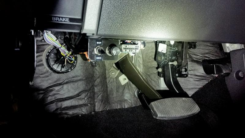

I just did this using the assistance off the videos from above. I didn't opt to use the relay to give a ground signal to trick the truck's computer. I still have to depress the E-brake.
Since Radio Shack is gone, I ordered my parts from Digi-Key
SPDT switch - CW161-ND
Potentiometer (50K) - CT3063-ND
Knob for Potentiometer - 226-4101-ND
If you flip the switch one way, it goes into Battery Charge Protection Mode (BCP). Go the other way is the normal Stationary Elevated Idle Control (SEIC). The potentiometer adjusts the idle. Activation of the idle control is via an upfitter switch.
I made a bracket that attaches off the OBD2 port. If anyone need me to do a schematic without the relay, let me know.

Looks good!
Thanks for the part number on the knob. It appears to be the exact one used with the shift on the fly kits. I just installed mine & now my OCD is bothering me seeing as they don't match. Think I'm going to order one.:redspotdance:
