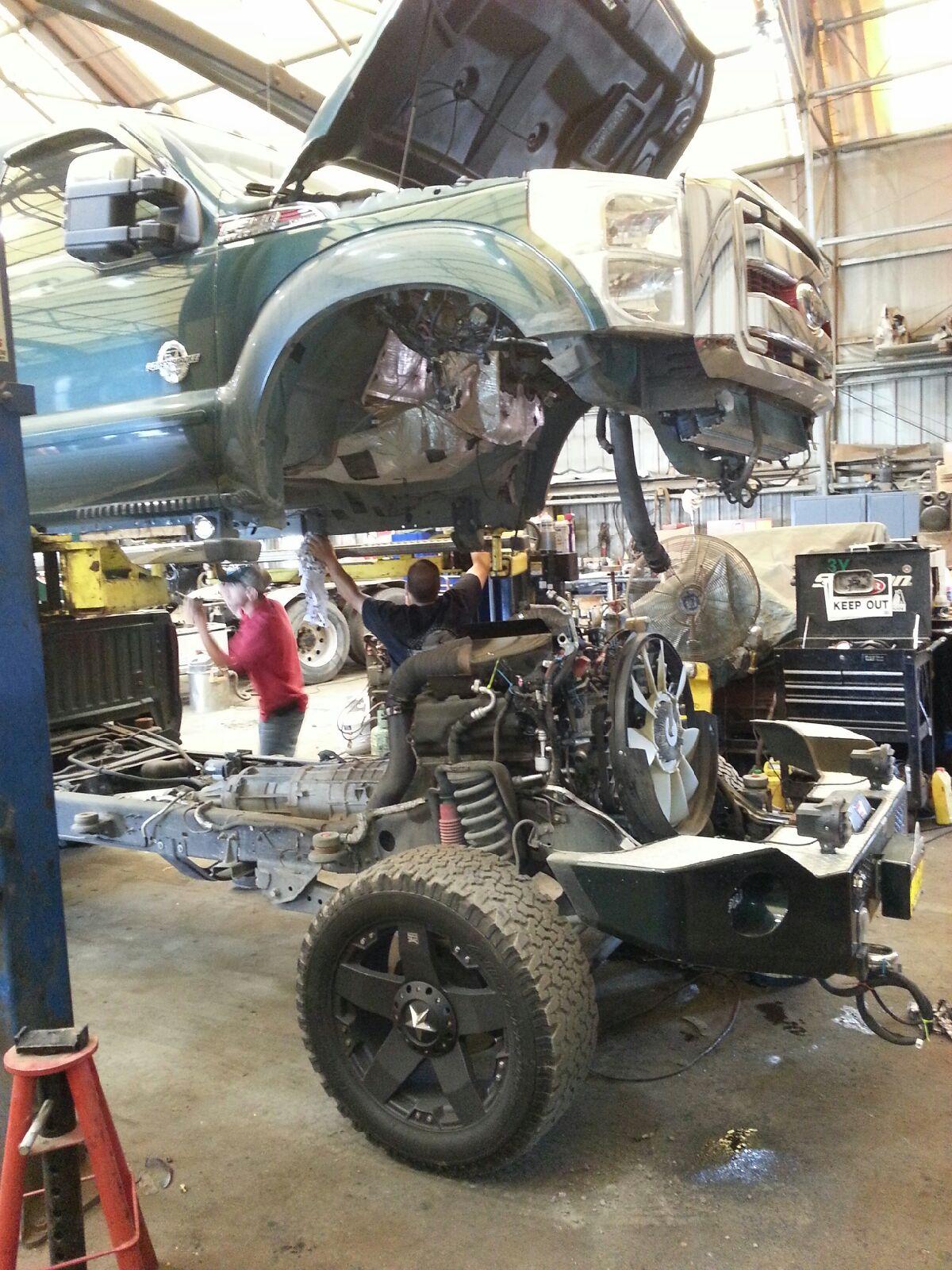

Finished up the Newton Lift Fat-Boy 4Link and Cal-Trac Bars this morning.

Took about 5 hours to get it in the air this was the first one I did. Just a few more harnesses than a 6.4 or 6.0 but overall not bad

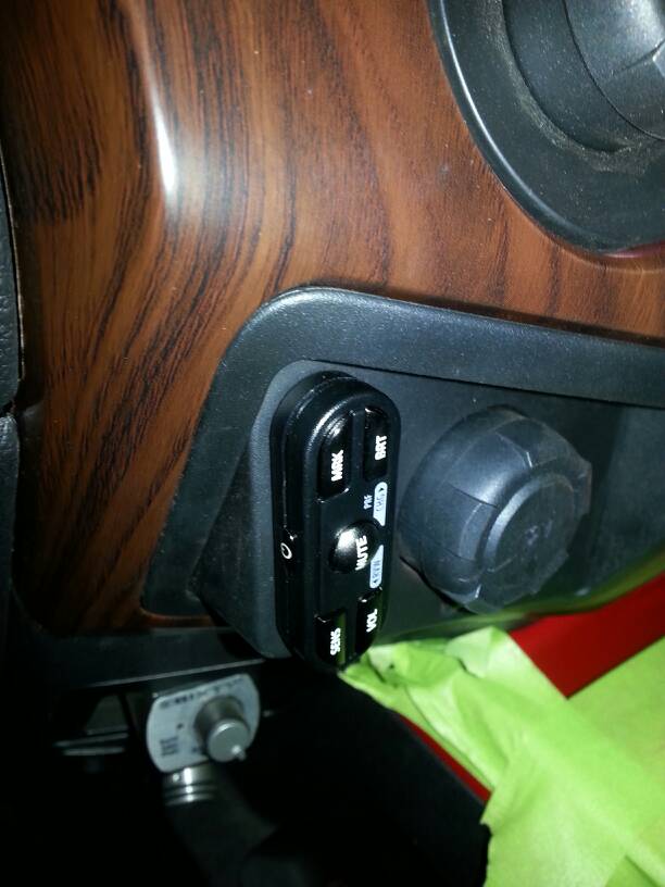

Finished all the in cab wiring, gauges and Escort 9500CI last night

Damn you need to do a write up on putting that escort in there...I like it
Putting the escort in wasn't bad at all kit comes with everything to flush mount the led screen and control is pretty much up to you just have a drill a hole big enough to fit a phone jack through. The hardest part was finding a good spot for the comm. Box and speaker with everything going on under the new dashes. It ended up on the passenger side near the fuse box

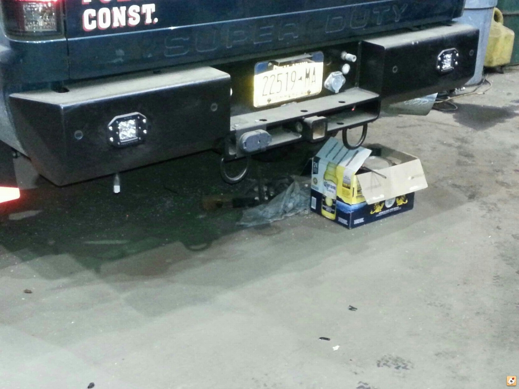

where do you hide the sensors at? i really need to look into this
powerstroke22
Apr 17, 2013
591
Long Island, NY
If you look at the picture of the rear bumper you'll see the rear sensor on the license plate. The front sensors are mounted to the bumper on my truck I'll get a picture. I have a T-Rex grille on the truck so I couldn't mounted them there but I did another 2011 and mounted them right to the grille surround.
