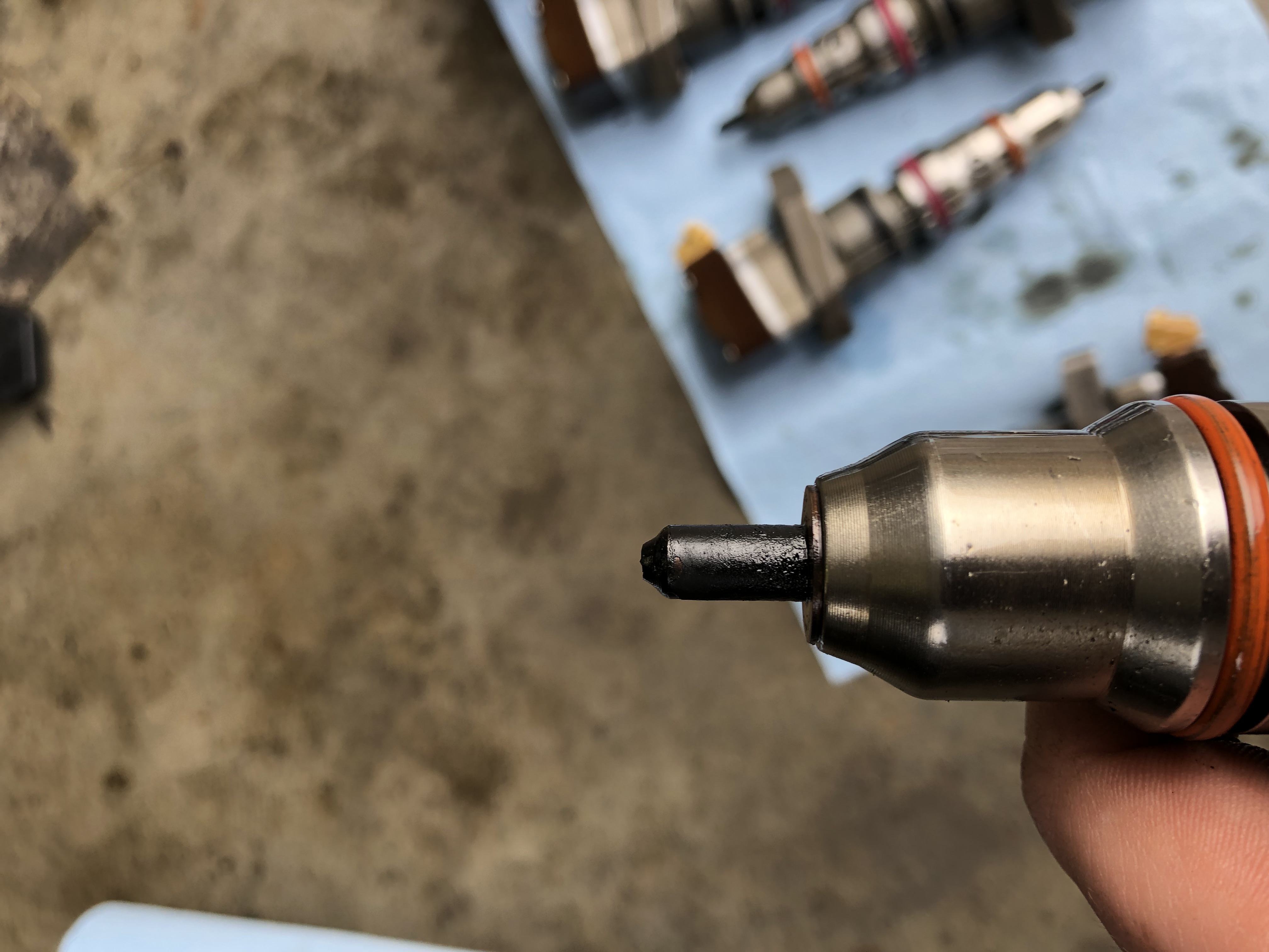

Well I'm guessing I've found my issue why my truck has been running like crap.

I have no clue. Have always had a fuel pressure guage. Have always run quality fuel with high turnover. So idk. I was never truly happy with the 175/80 so kinda a blessing in disguise now I can get something different.

Either way should have some full force 180/30 injectors coming. Should do good with the new 364.5. Hoping to have a tow beast when this is all done.
