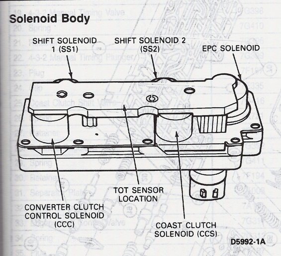

The factory TFT sensor is located in the solenoid pack of the valve body. Refer the the attached picture.
You shouldn't be seeing 230-250 cruising empty. Something is funky.
What was your glow**** gauge reading before it broke? Temperature variance between the test port and solenoid pack should be minimal, so if you noticed a spike when you started using the ODBII port for the reading I would suspect an issue with the factory sensor. You can check the solenoid body connector for dirt/debris that would cause the TFT sensor to malfunction, and ohm out the connector. I'll see if I can find the ohm procedure.
Thanks Backwoods I never did get a full actual temp reading because it broke a day after I put them in (Glowshift Quality For Ya).

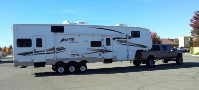

It's got to be a bad reading or something is seriously wrong. Pulling my trailer through the sand my trans doesn't get to 200.
