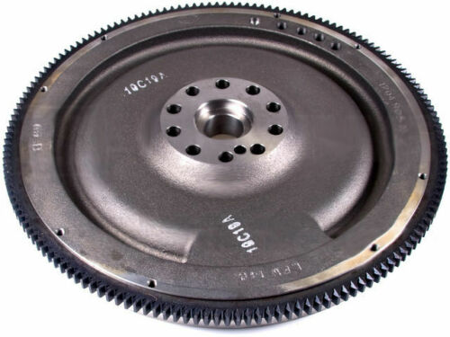

I looked at another 7.3 balancer and flywheel and they both have counterweights. I assume this means that motor is in fact EXTERNALLY balanced. That being the case, I suspect that I have not indexed the flywheel correctly.

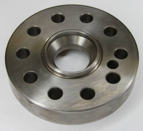

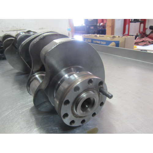

I now realize that there is a spacer on the back of the crankshaft. All of the pics I find show this spacer as having just one hole, so no confusion there.

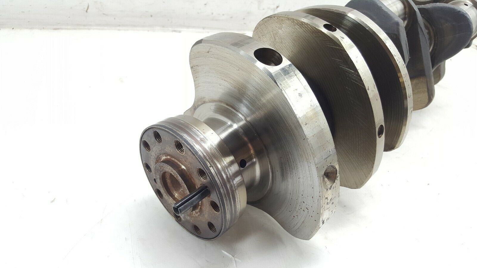

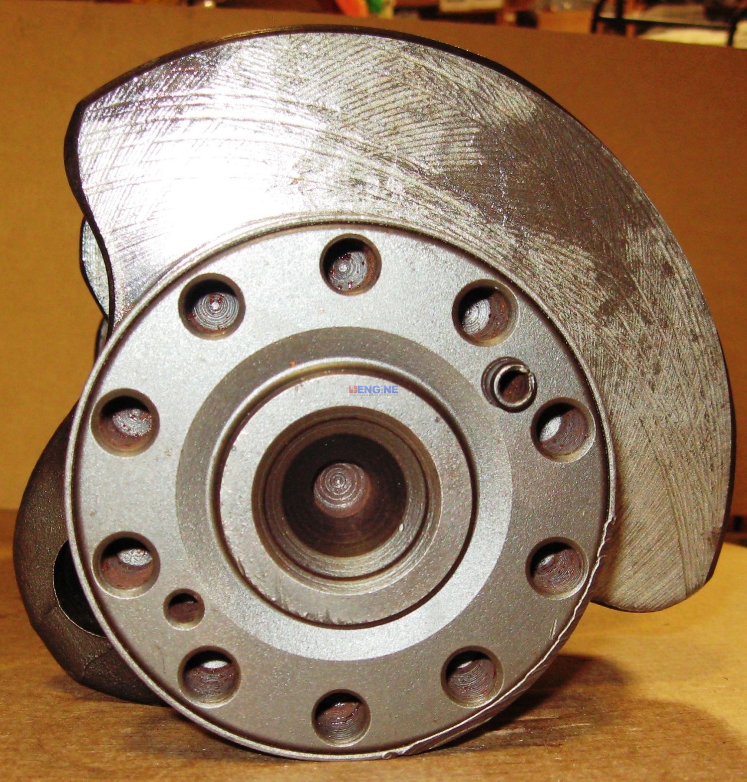

HOWEVER, I have found pics of 7.3 crank flanges that have either 1 or 2 holes for alignment dowels (see pics). What's up with that!?
I'm starting to wonder if the reman motor that was installed before I got the truck might have one of those "2 hole" cranks in it and the spacer was put on 180 deg out of phase. If so, when I aligned the flywheel with the spacer hole it threw the balance way off. That might explain why I originally found the flywheel oriented with the alignment hole 180 deg away from the spacer hole. I was thinking the fella before me didn't know what he was doing. I'm starting to think maybe he DID know and that I'm the idiot!

I think I answered my own question... the crank with the 2 hole flange seems to be for a 95-97 that is an entirely different animal with hollow rod journals.

Today, I compared my flywheel indexing to another motor I recently pulled from a parts truck. On that motor the counterweights on the flywheel and balancer are opposed (180 deg apart). On my motor, I installed the flywheel with the counterweight aligned with the balancer counterweight. So this seems to conform everything I had feared.
I sure wish someone that knew the real deal would verify this, though.

- I found a couple more pics of '99-up crankshafts that have 2 holes in the flange. The 2nd hole, opposite the dowel, appears to be smaller diameter.
- There should be a 3/8 x 2-1/4 roll pin in the alignment hole, Ford part #20640-R1
I'll need to confirm all this and I'm still at a loss to explain how I got my flywheel 180 out. I'll find out when I pull this trans out again.
