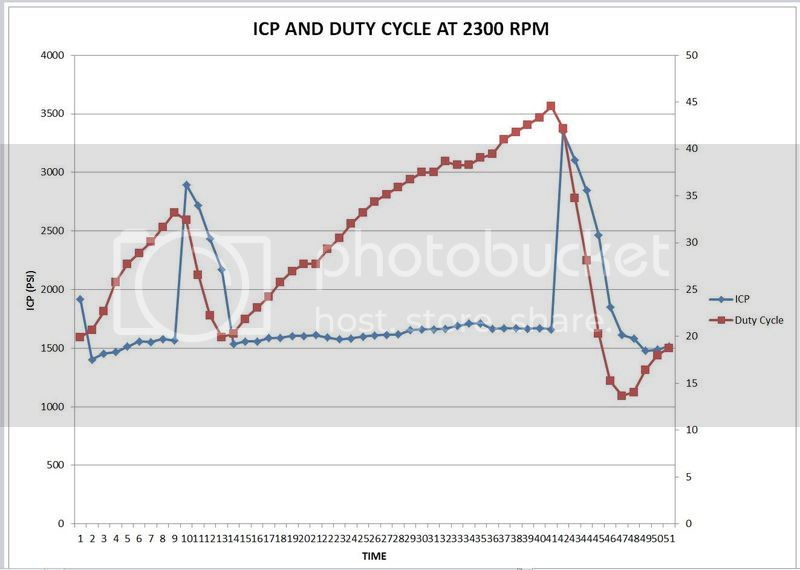

Also, tonight I was data logging and noticed that the ICP would spike over 1000 psi and the injectors would start making more noise.
I got this weird anomaly after the check engine light came on. With the RPM and ICP steady, the duty cycle began climbing. It kept climbing up to almost 50% and then the ICP spiked to 3500 psi and the duty cycle dropped.
What would cause this? Bad HPOP? Leaking injectors? It seems more noticeable when the engine is warm.
Here's a chart of the ICP and duty cycle.

Ryan, with those codes, Im not sure you still don't have a damaged pcm issue you're chasing. I don't know those codes to be typical.
What exactly were you doing with the pedal in that datalog event? A steady 2300 cruise would not cause the IPR to behave like that. Its like the power to the IPR comes/goes.
I was holding the pedal steady. I have the RPM data to match to prove. I just didn't plot it. I had it do it again when the cruise control was set on a flat road.

I don't know how all of the parameters are related, but the injector PW, the ICP Voltage, and the ICP itself all have the same graph over the same timeline. During these weird spikes in the graph, the MFD is fairly steady. The plot is almost flat.
I guess my question would be..... What would cause the ICP to remain constant at a constant RPM, but cause the duty cycle to steadily increase until it hits a point and causes the PW, the ICP, and the ICP voltage to make a drastic spike?:shrug::shrug:

So, the computer is seeing a flat ICP, but Duty Cycle is climbing.
Duty Cycle reaches either a time or energy saturation, and the ICP spikes.
Computer sees high ICP and drops Duty Cycle, ICP follows.
Under the assumption that the computer wants more ICP than it's getting during the flat-ICP time, my first question is whether or not the ICP is actually flat during the climbing duty cycle.

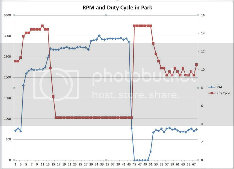

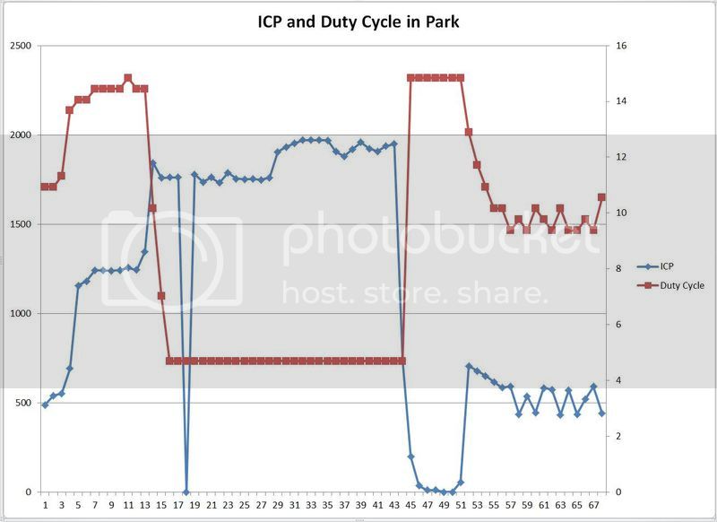

Here is a graph of ICP and Duty Cycle while the truck was sitting in park and it threw the P1211 code. When the ICP went to zero, I let off the throttle and the truck died. I revved the truck up to almost 3000 RPM when the ICP spiked up and held it steady.
Here is a graph of the Duty Cycle and RPM over the same time. The duty cycle climbs and then drops to 4.69% while holding that high RPM (over 2500). When I let off, the truck died and the duty cycle went up to 14% give or take. These two graphs are over the same timeline.
I'm pretty good with excel, but I'm not sure how to graph 3 parameters over time and give a vertical scale with each, so that's why I graphed the data on two different charts.
I noticed the ICP dropped to 0 on the graph. I'm guessing that's why the P1211 code threw.
I'm confused as to why the Duty Cycle dropped to 4.69%. Very odd......
