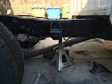

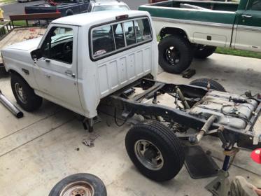

had a thread in a different spot but figured it belongs here instead, so here we go.
plans are to make it a streetable "race truck", gonna see a lot of track time in 2016 as well as pi$$ing off some muscle cars on the street. bought the truck brand new off the lot and heres how it sits now.
started out as a work truck
then stock with a super chip
then ts with exhaust/intake
then swamps 160s, custom tunes and built e4od
then short bed
now full out build!
truck is a 96 f250, 2wd auto.
chopped 16" out of frame, pulled together and bolted everything up like a factory short bed would be, drop hangers and shackles for rear, ruff stuff traction bars, 3.55 rear welded.
motor is getting built as we speak with all the goodies to keep it around 600-700hp.
will add more info in truck if anyone is interested or have any questions, well heres some pics!
