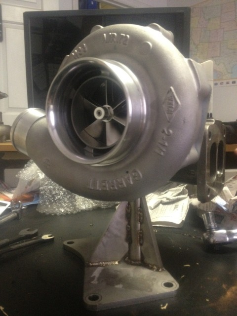

Drivability wise, 7-10 psi around 1900-2000, similar spooling to the jb 66 I had, I believe the bb 68 is where it's at.. After you get the 72 spooled. It wants to break tires loose at 65, pretty effortlessly, also pulled a low circuit code on #1 which remained from the previous injector swap so might have a short in a harness also.

Turbo specs:
Garrett GT4094R, .85 t4 housing, 77mm turbine, 72x94 mm billet compressor custom machined in a 4094 housing, dual ball bearing, water cooled center section plumbed just like a coolant filter, also have mount kits in stock for these turbos.

Good job, the combo of injectors and that turbo looks good. Looking forward for some numbers. Spool looks good, and sounds nice, glad to see more turbo options for the 6.0's.
