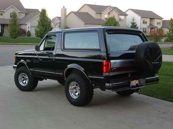

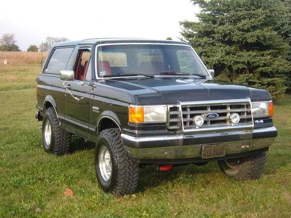

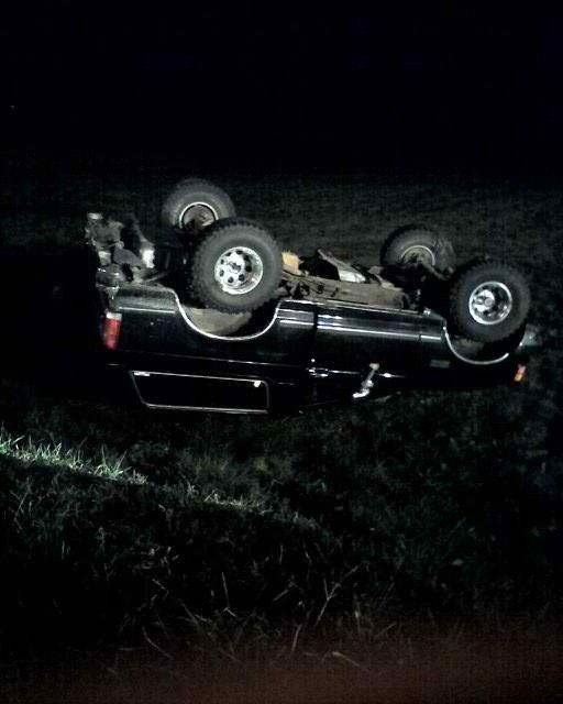

Here are some pics of my last 88 Bronc - it was my first truck that I had also built with my father but ended up turning into a bad night... This project will eventualy be Black aswell but lets hope I can keep it without wrecking:)
