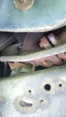

Hey guys Im sorry if this is a Duplicate again, I have a 97.5 which is the time they were slapping turbos on the IDI to keep up with Cummins. I need the exhaust Y pipe collector piece, its in-between the manifolds and the turbo. I think I added a photo, its from the passenger wheel well.

IF you guys know anyone at a junk yard have em keep an eye out, theres a photo under my first post of what it looks like (from the passenger wheel well.)

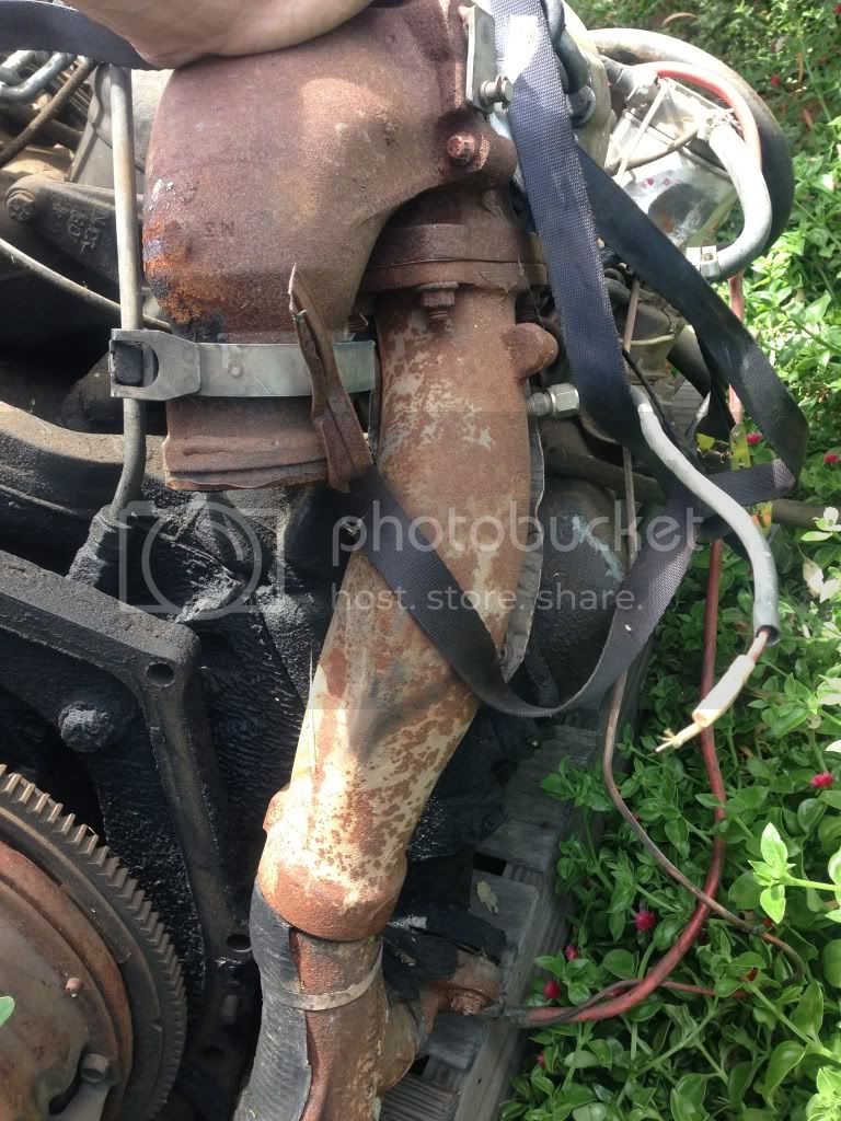

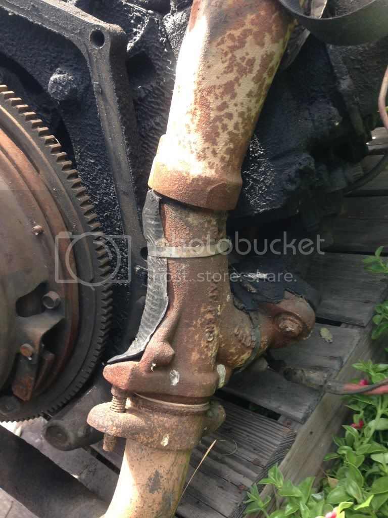

Dieselboy
185
Mine leaks at that joint too ill see if I can locate one or I may change my up pipes to run a different turbo. I had luck getting parts from ats before but it seems they're gone? It was 4 years ago that I put the same motor mid 94 idi turbo into my bronco. I have my engine on the ground so ill snap a few pics for you tomorrow.
Redman920-06 350
Jul 11, 2013
135
Wisconsin
sounds good! Lmk, BTW love the fact you put a IDI in your Bronco haha.
Dieselboy
185
Try calling ats. Last time I needed something the guy just went into the shop and found me one lol. Ill be taking mine apart in a few weeks and I don't know if I'm going to use it or not but here's pics of what the Y and up pipe looks like.
