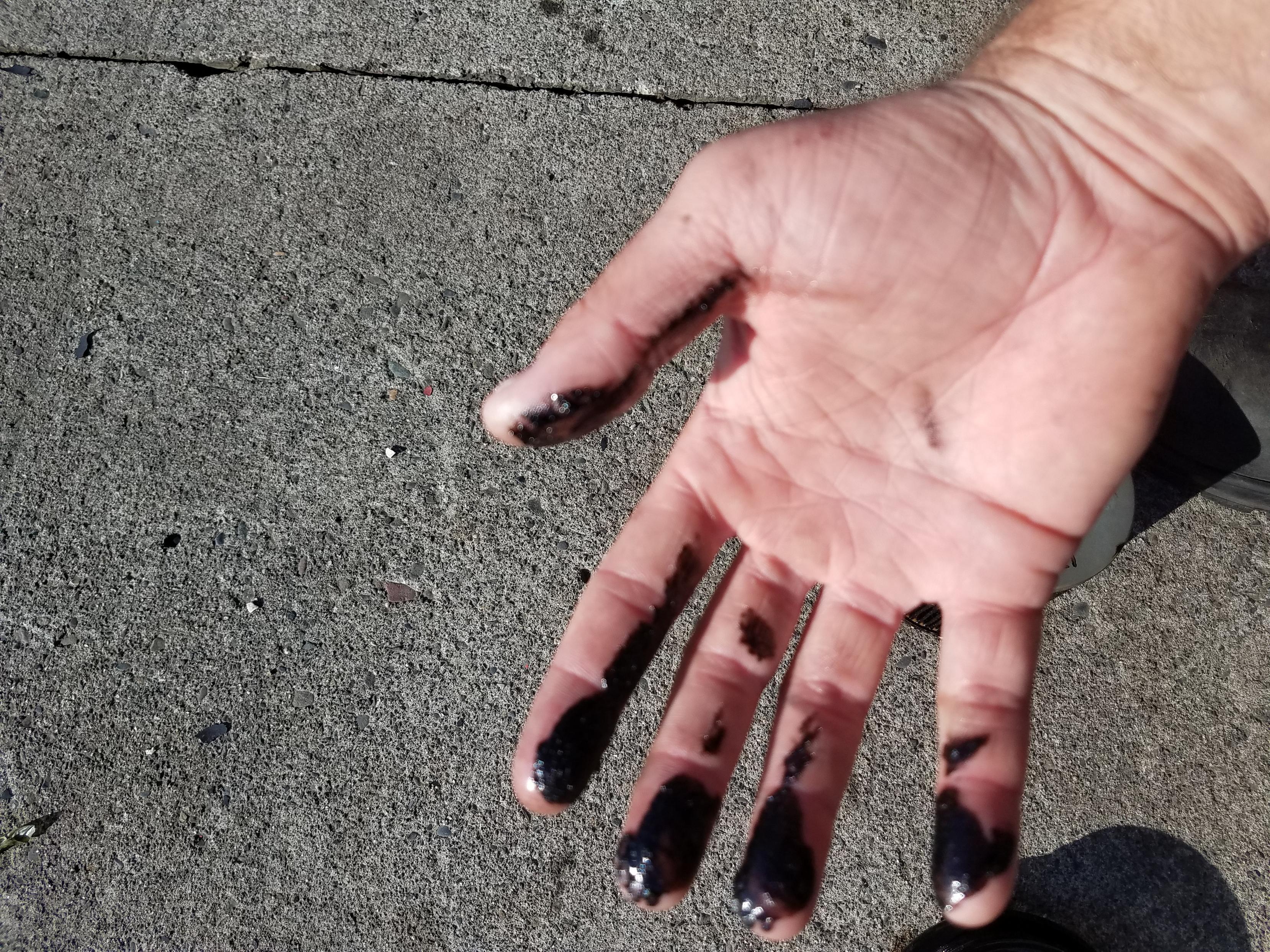

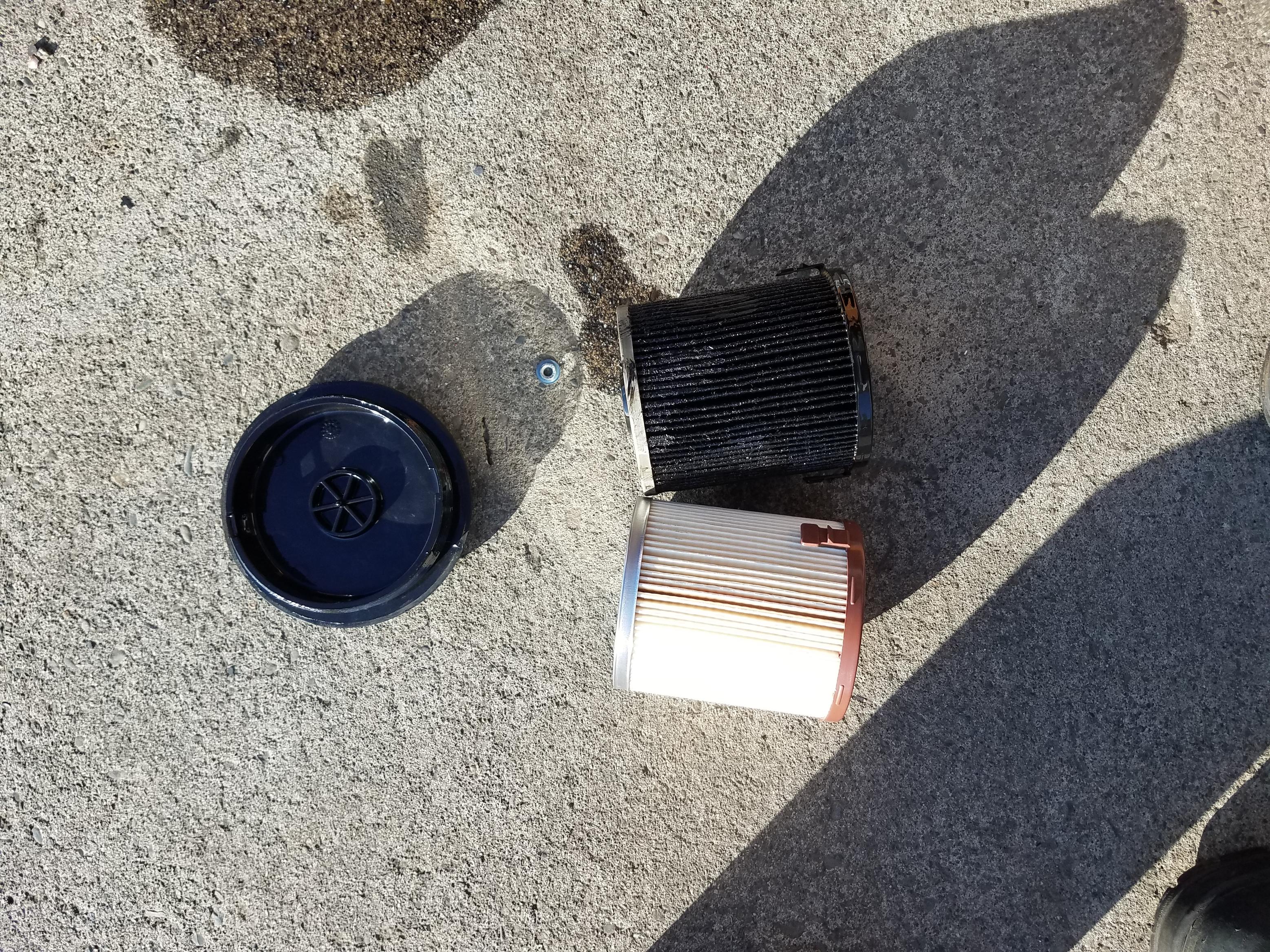

Should have been first on the list... but I finally got around to checking the fuel filter. Holy crap! It was as black as an oil filter with 30k miles on it. It was slimy and gunky and I don't know how fuel was even getting through that sucker. Un believable! (Any ideas on if it was dirty or if it has bugs? Never seen a fuel gilter so bad in the last 9 years and im a Marine engine mech) Anyways drained the bowl and replaced filter. Still no change in driving characteristics. I'm gonna pull the filter again today and vacuum out the bottom of the bowl and the little return hole in the housing. (Maybe the return mesh filter is backed up?)

Alright. So I cleaned out the fuel bowl... Probably a 1/2" of crap in the bottom, and cleaned the return screen (wasn't terrible) I also removed the fuel bowl heater because it was broke in 2... Probably the original.

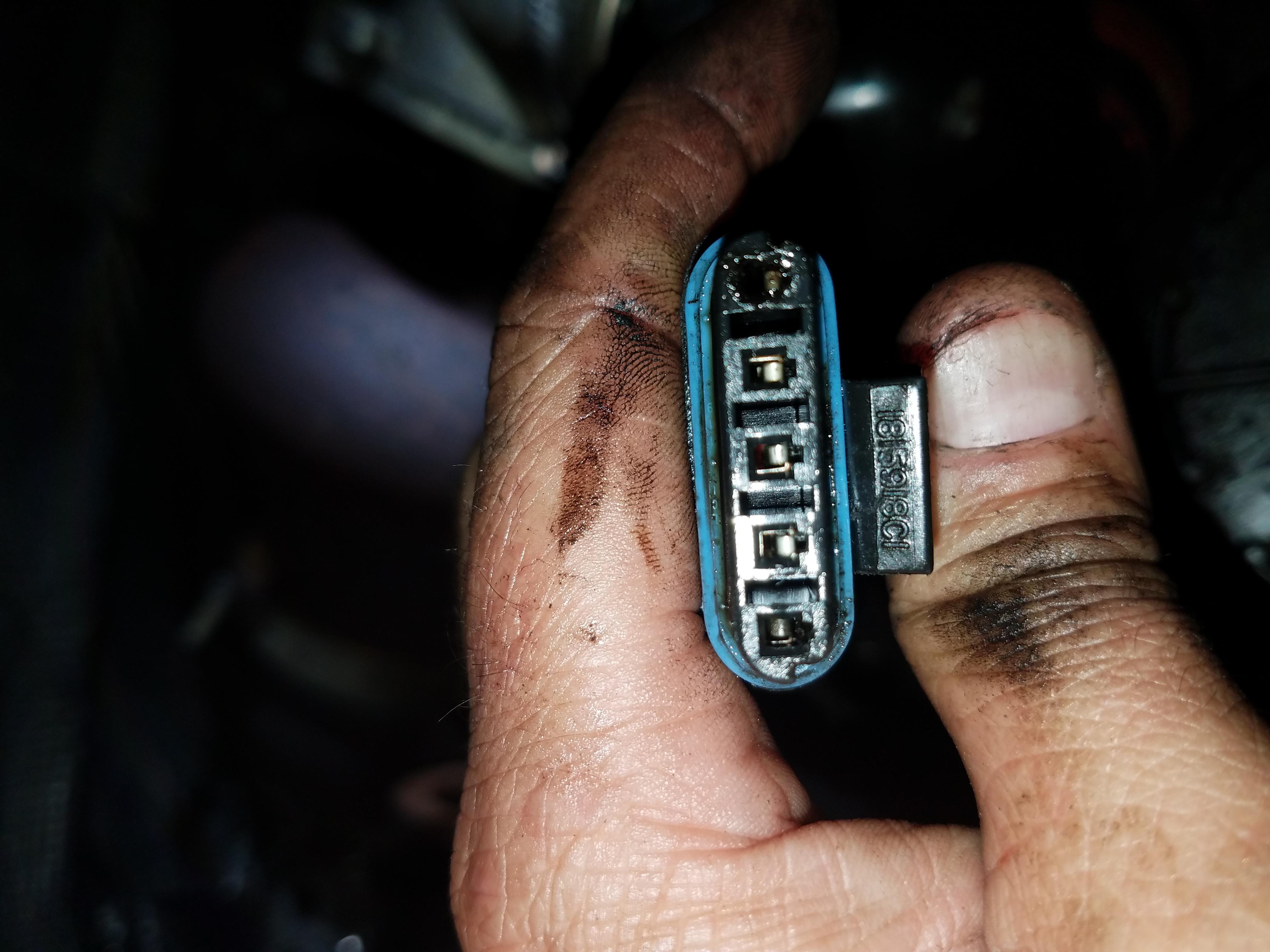

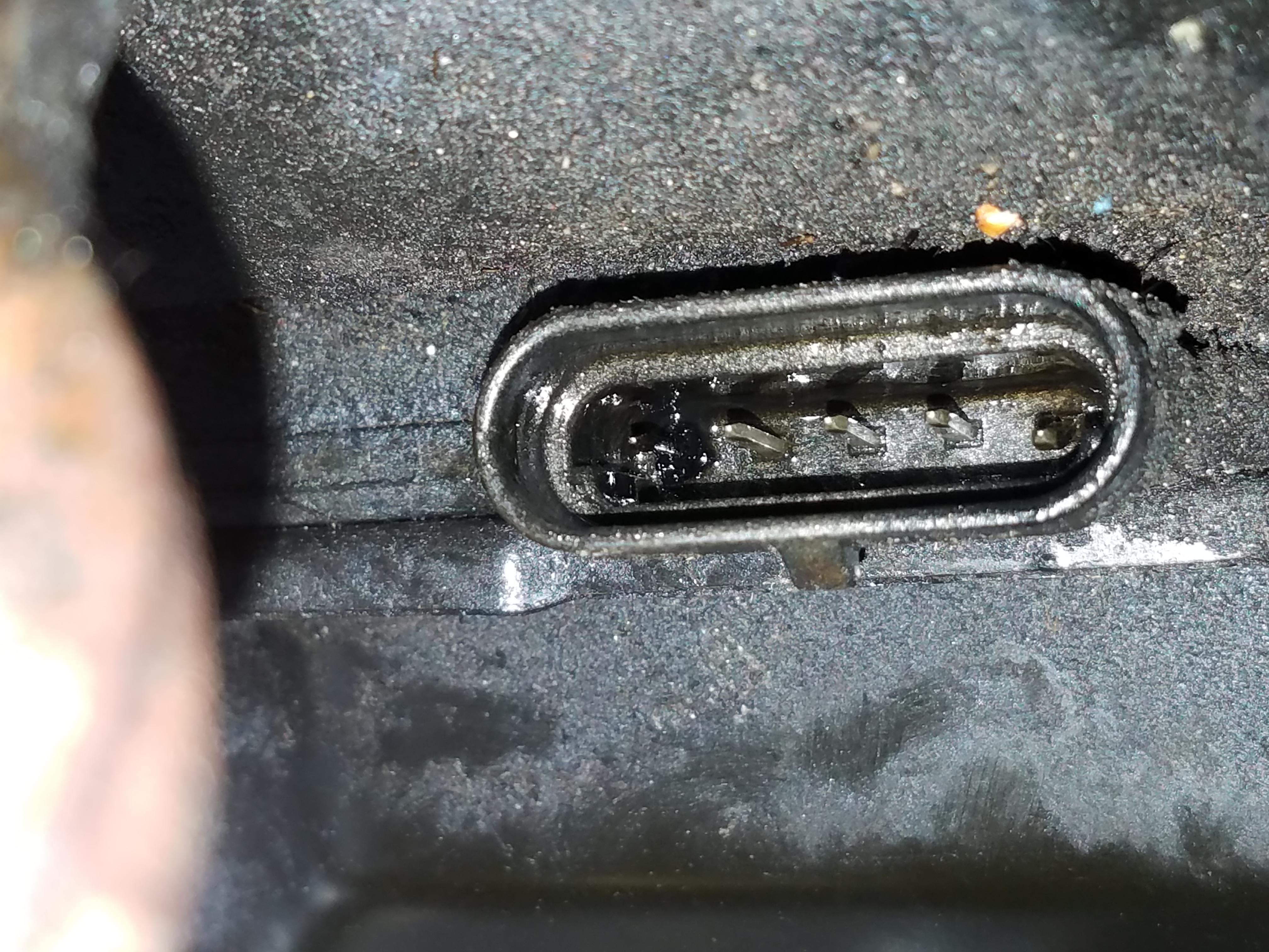

Those terminals are for the glow plugs.
Fuel pump should have some fuel pumping in the bowl. Might be a bad pump.
