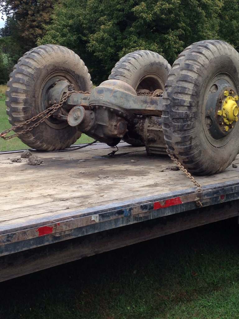

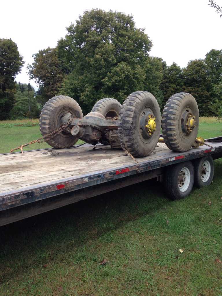

Well my 97 that iv had since I was 19 got totaled and my mud truck bronco got the axles destroyed this summer so I can only fix one so I have decided to build me a monster truck. I just picked up a set of 5 ton rockwells and a 5 ton military case with roll around tires.

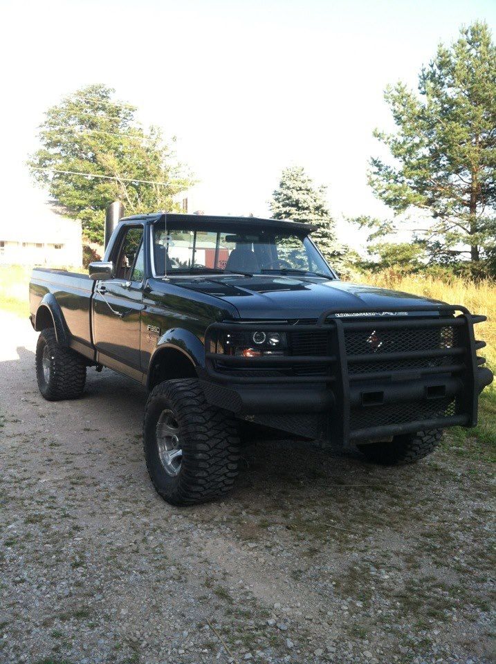

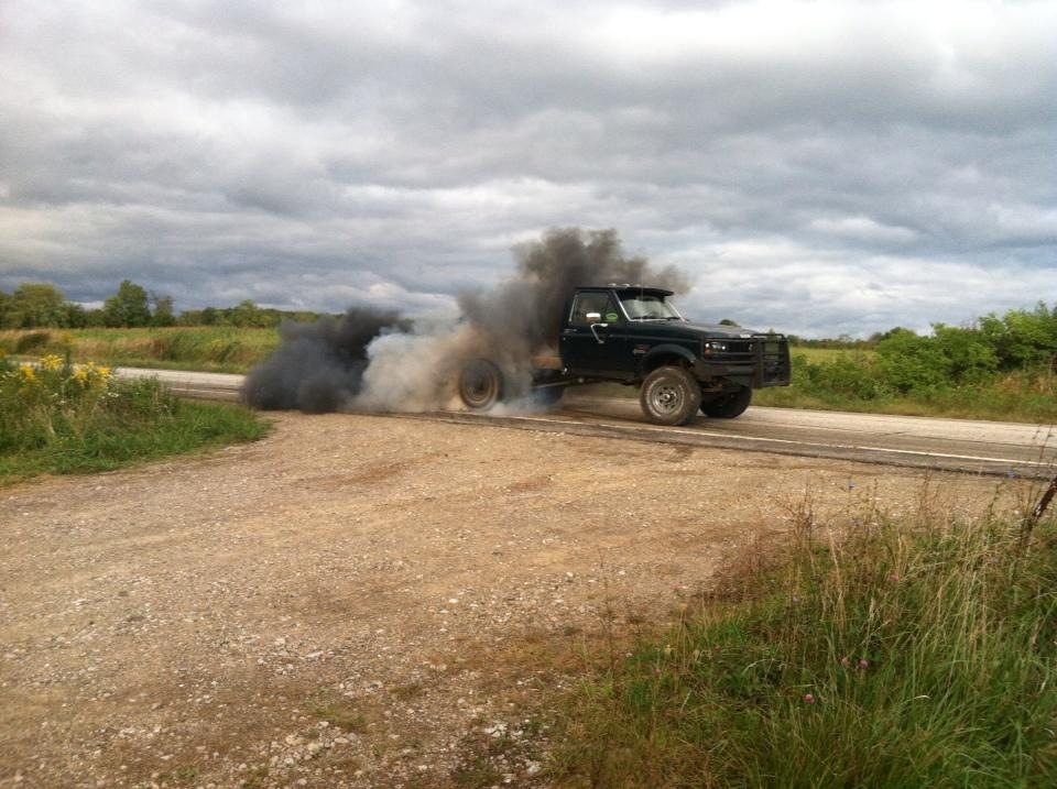

ImageUploadedByTapatalk1379884215.780566.jpgImageUploadedByTapatalk1379884239.163002.jpg
This is what she once looked like.

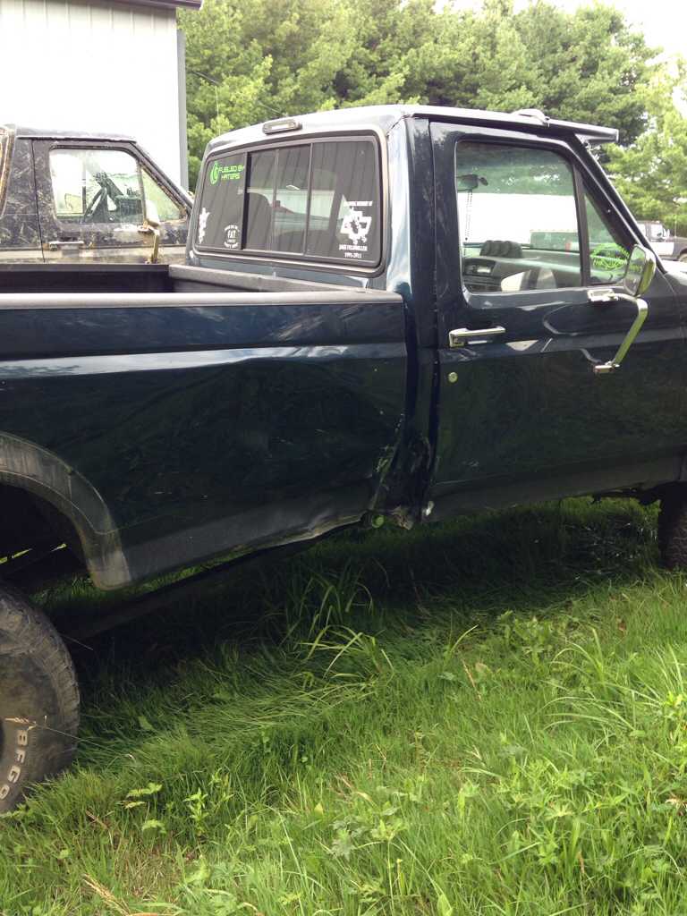

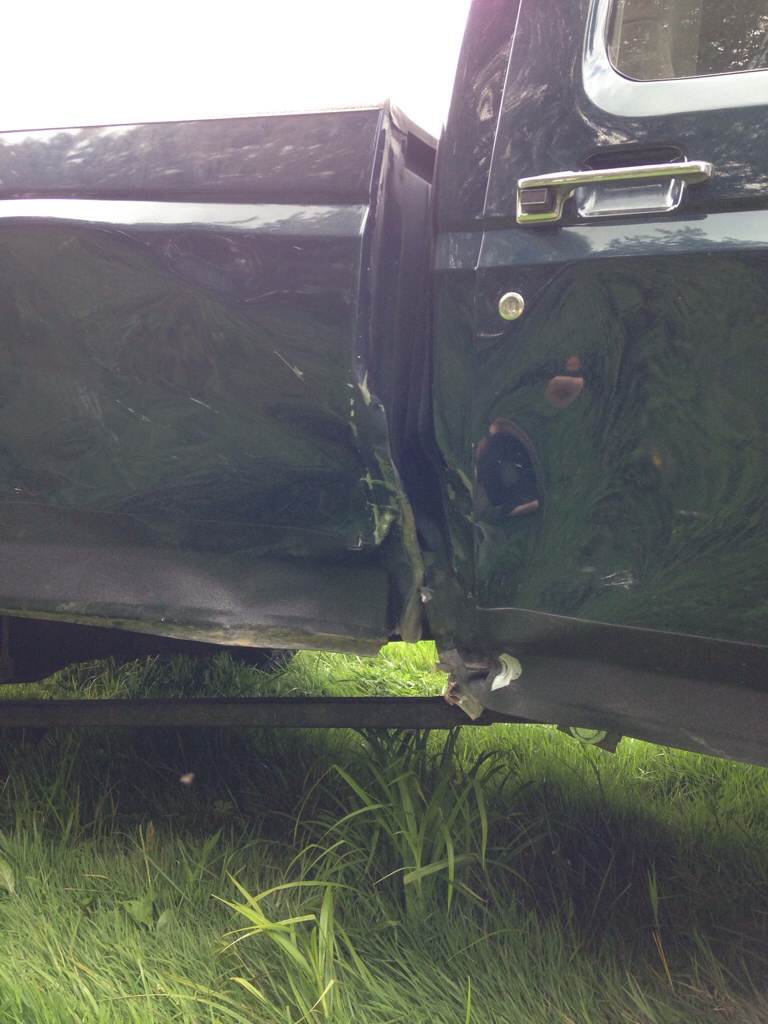

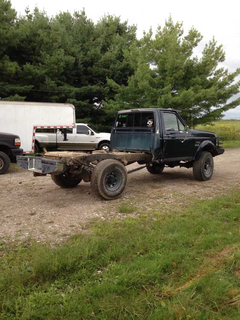

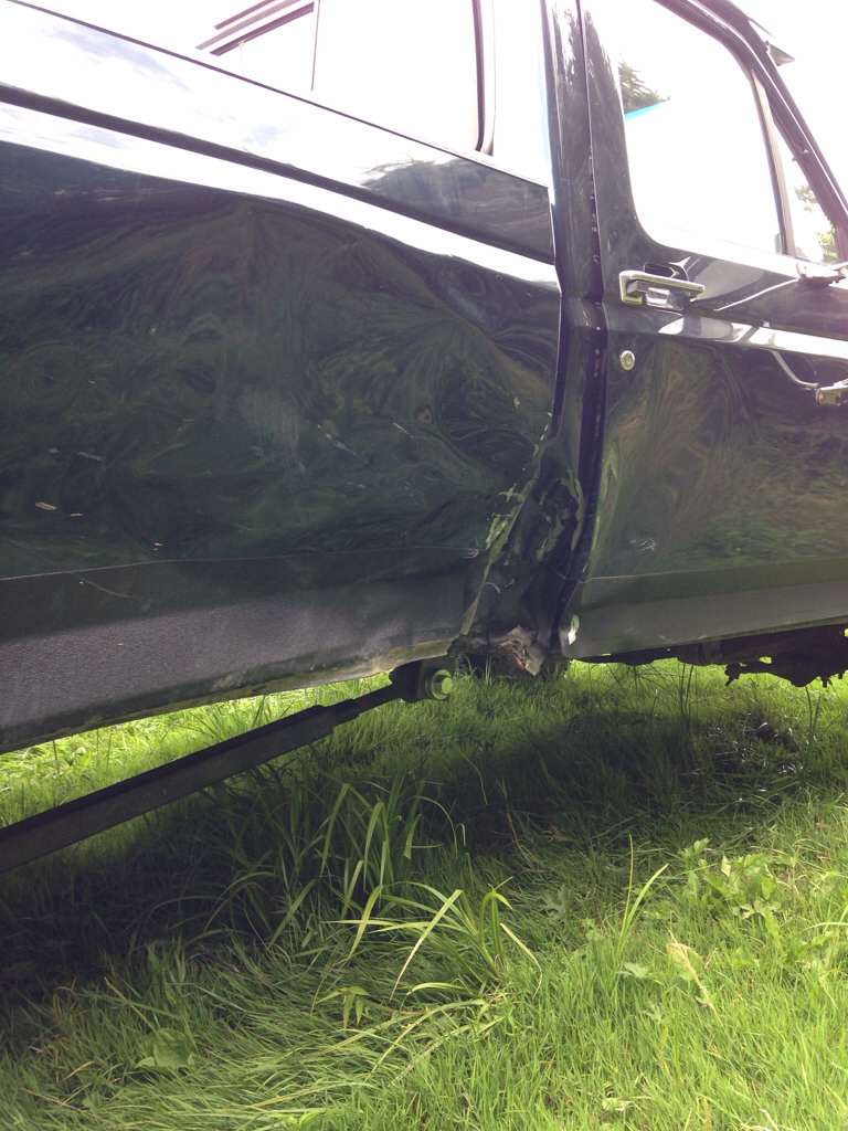

ImageUploadedByTapatalk1379884285.863097.jpgImageUploadedByTapatalk1379884297.979739.jpgImageUploadedByTapatalk1379884319.413094.jpg
This is what happens when a full size Harley runs into the side of your truck

They are from a 6x6 but the beefed up heavy version of the deuce axle. These are 5 tons not the 2 1/2 ton

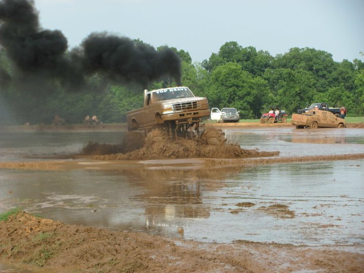

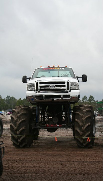

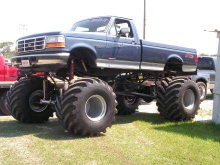

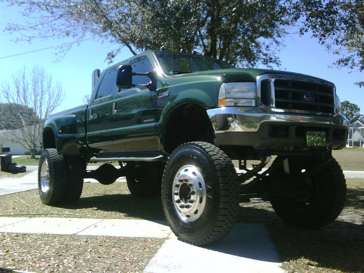

We have helped in a few builds...........this is just a few. Don't have pics for the big ones handy. Working on another right now.
97BambiBasherPSD
Jun 13, 2011
769
Edinboro, PA
Any info on top heavy, the white SD, and the blue OBS? Super sharp trucks.

Top heavy was our old shop truck. 160/100 injectors and BDP chip. 5 top four link coil overs and 28l26 tires.
The blue truck was 160/stock inj and our tuned chip. 2.5 ton with 2" 47 spline axles from overson and 48-31-20 tires. Also four link coilover.
