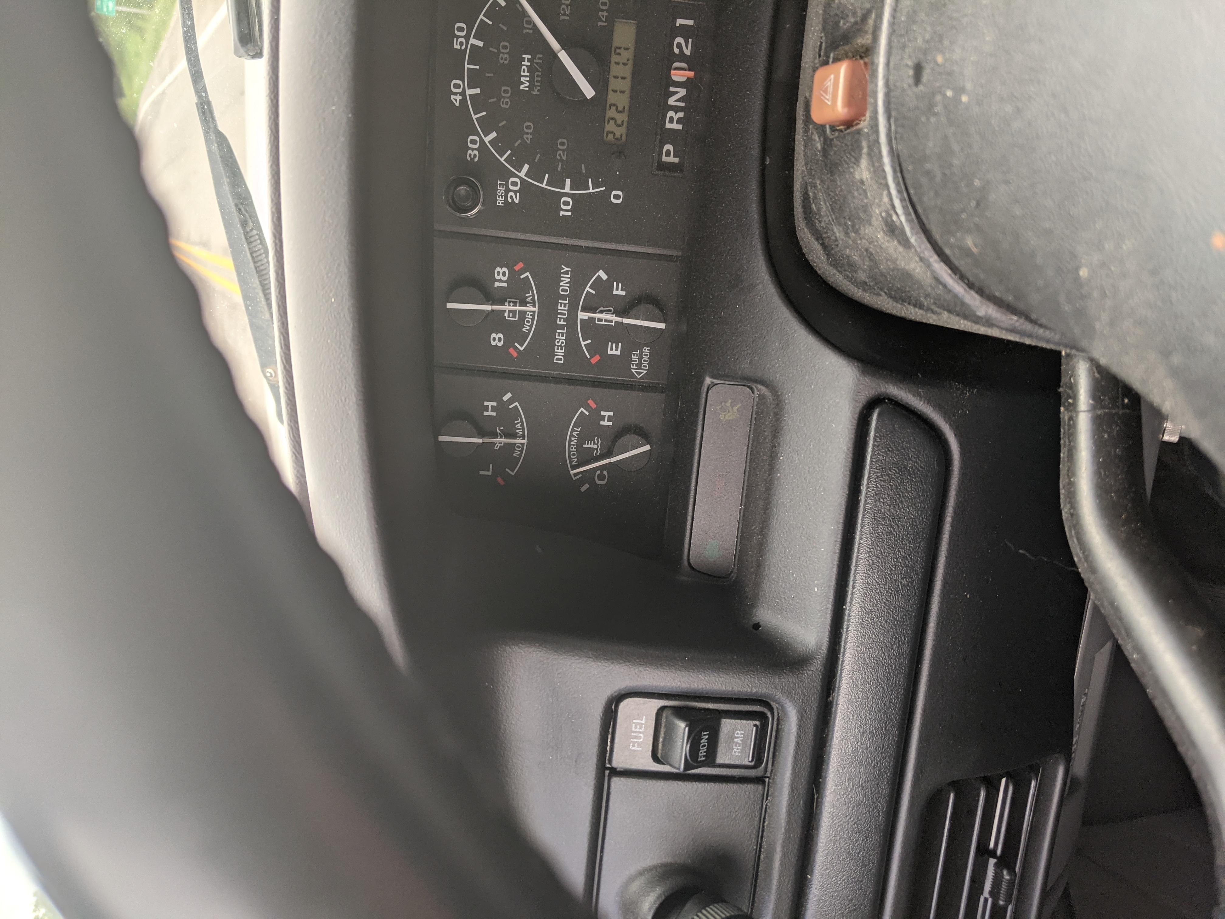

I have attached an image of my coolant temp gauge running 65mph down the highway on a 75 degree day. Empty truck bed and not towing anything. According to torque my oil temp was 190.4 when i took the picture. As you can see, it's barely into the normal range.

You don't understand how inaccurate Ford factory gauges are.
Put a real gauge in it. Take like 15 minutes.
