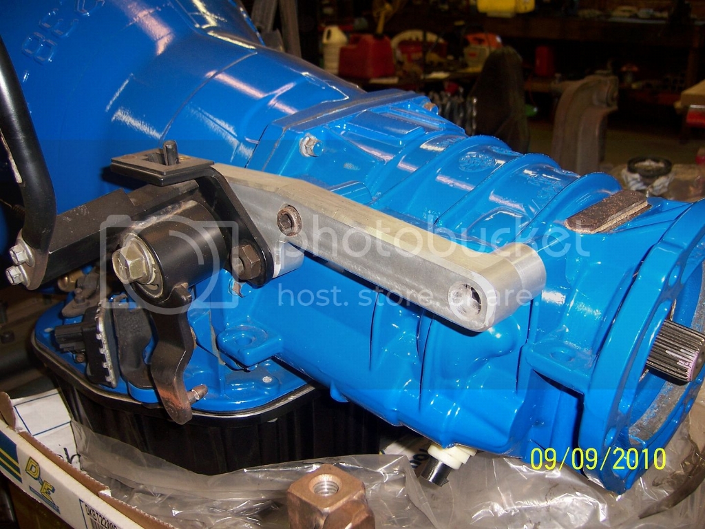

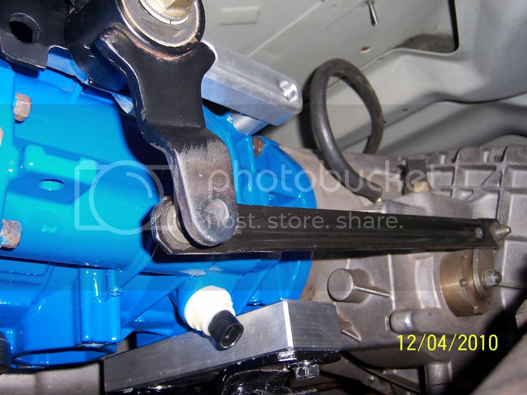

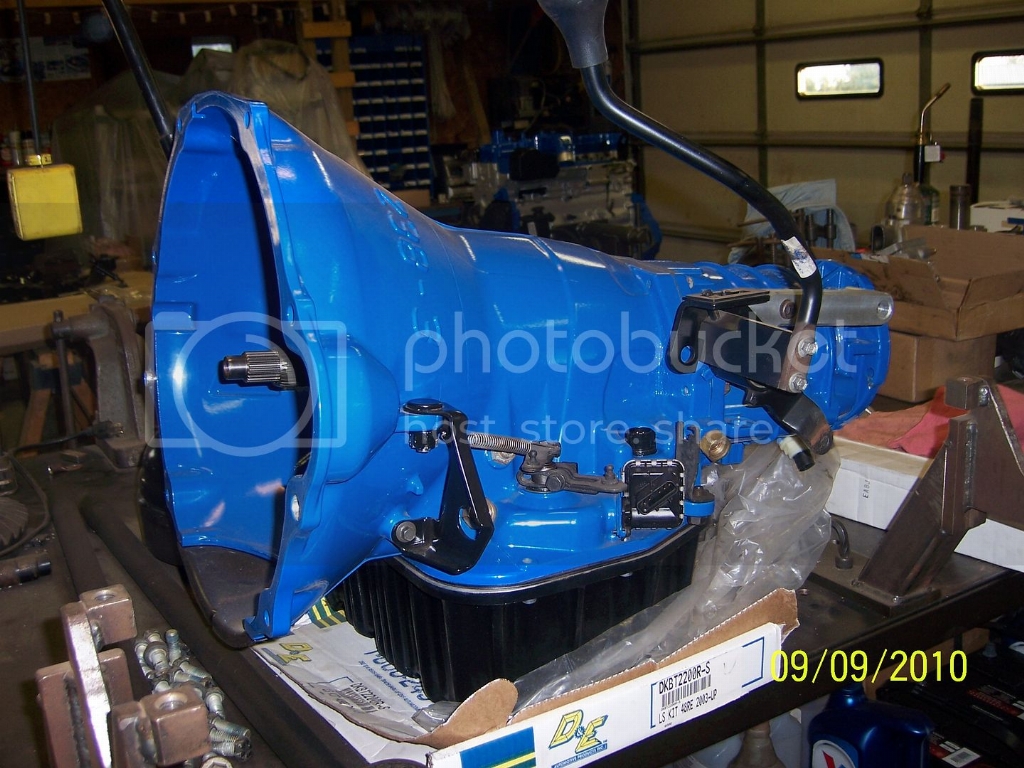

this is in my superduty, but maybe it will give you some ideas. 48RE to a 271F

Is that a factory dodge bracket?

I just threw out the modified linkage I made to adapt to a 48RE !!! It ashame, But I cut the OEM linkage and re-clocked it then welded it back together. shortened the linkage arm and it worked perfect. I mounted the works to a 1/8" steel plate and bolted that to the tabs on the 48RE
