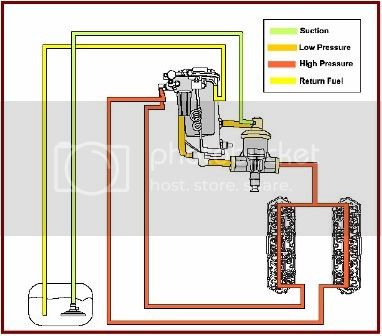

Any idea why the schrader isn't spitting out any pressure? Could the regulator be bad? I didn't separate or work on the regulator at all. The bowl slowly empties after cranking. But it does not appear to be refilling. Shouldn't there be fuel up to the top of the bowl when working properly?
And a couple clarification questions.. Does the fuel bowl filter from outside of the filter to the center. Or from the center out? And is the feed for the high pressure side of the fuel pump at the top right of the bowl before it goes to the FPR?

You need to see where fuel is and is not at. Start at the fuel pump.
