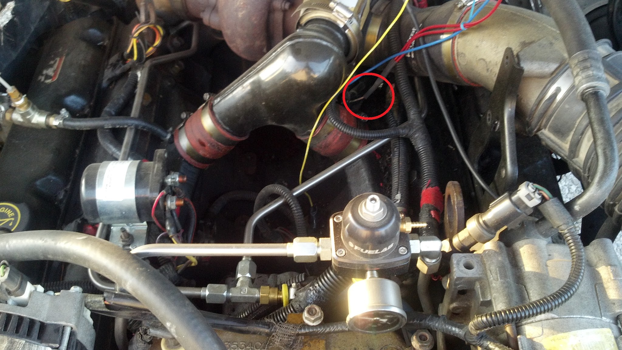

Disregard all the random wires and stuff in the picture, but the connector for it should be below the turbo/y-pipe area. It sure sounds to me like the EBPV is what you are hearing/feeling. I am not sure of your location, but in Iowa in the winter I can drive half an hour on the highway, and it will still do it when I get to work. Its also cold enough when I get into town, the temp drops just driving around town (at least according to the idiot gauge). It should go away if you get on the go pedal, and come back as you let off.

It does exactly that, I am not sure if you watched the video but it will go away when accelerating and come backlight after I let off. The picture is very helpful, I will remove it once I get off work and see if that fixes it!:redspotdance:
