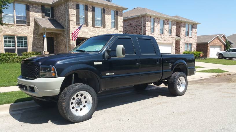

Hey y'all,
I'm pretending to think I can afford mods for my truck later this year. 2003 ccsb
Currently has 4" lift on 35s
10 leaf front
4" block (stacked w/ factory)
I want to get up on 38s... here's what I'm thinking:
4" Pmf Shackle/Hanger kit
7"ish PMF block in rear, no stock block
I do realize there will be a dudebro rake.
Big questions are:
Is a 7" block absolutely crazy? Even w/ traction bars?
Is there a more cost-effective way to do this?
I have the factory tow package with rear sway and the dump-truck leafs. Would love to find a softer rear (have helper bags to install), but I would also like to stay married lol.
TIA
rman
Mar 17, 2015
209
SoCal
Also, I bought the truck already lifted. I determined the lift by measuring hub-to-fender and google.
While it measures like a 4", my 35s seem very small. Leads me to believe another 4" in hangers/hackles/blocks will net me a true 4" and 38s won't be an issue.
Also plan to switch my current 20x10 to 20x12, both with 4.5 BS
old pic. horrible color scheme lol. Plan to shoot the whole damn thing in bedliner.
Also got a new bumper and PF/PT mirrors. Just need time [emoji849]
