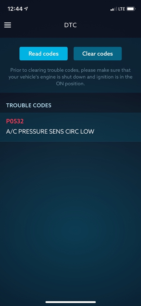

Probably the AC pressure switch. Iys right,down by the air,box. Theyre junk, will typically set a p0532 code, that you may need a good scan tool to read. Ive done a ton of them...

Nope, thats the code for the pressure sensor, its in the manifold lines, just behind the air box
