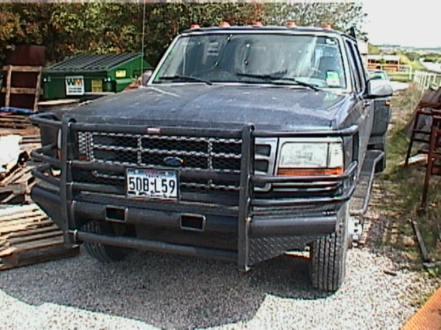

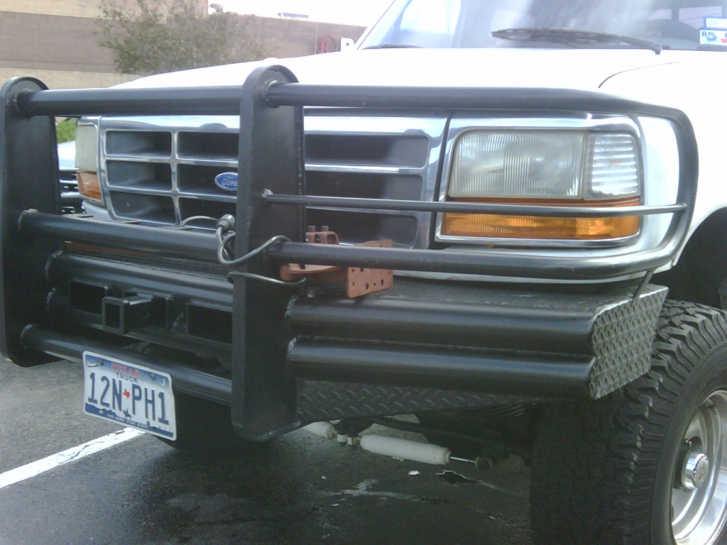

Oh, man, I think you just showed me the base concept for mine! I think i'll do the grill guard part different, but i'm definitely diggin the double pipe ranchhand kinda thing... maybe the double pipe base with the folding stand/workbench/seat thing... hmmm... thanks man!
700
Austin, Tx

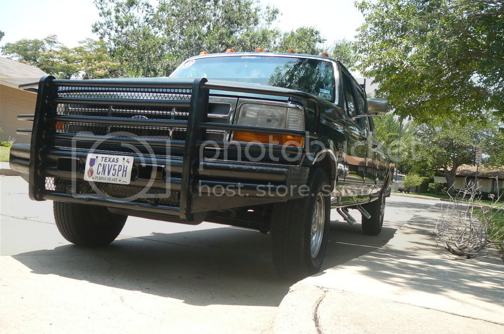

Anything you would change about them? I'm pretty set on using round pipe as a base, but I've been considering adding flat steel to make it even sturdier... I want to make it as strong if not stronger than a Ranch Hand...
I wouldn't change one thing about my bumpers. They are really strong, the winch cradle fits a Warn M12000, and the mounts don't just mount to the weak factory mounts. They mount there and back to the sway bar bracket so you can actually push and pull on it without bending those crappy bumper brackets. Wouldn't even change anything about the rear bumper. It's clean, wraps around the corners a little, and strong. Only downside is that I have to use the ramps to put it on the trailer now. Before, when it had no front bumper, I'd just crawl it on the trailer with no ramps. LOL
Of course what I use that truck for is different than most here. Whatever you do with your front bumper, I'd suggest reinforcing the stock bumper mounts or add in extra mounts to somewhere else on the frame.

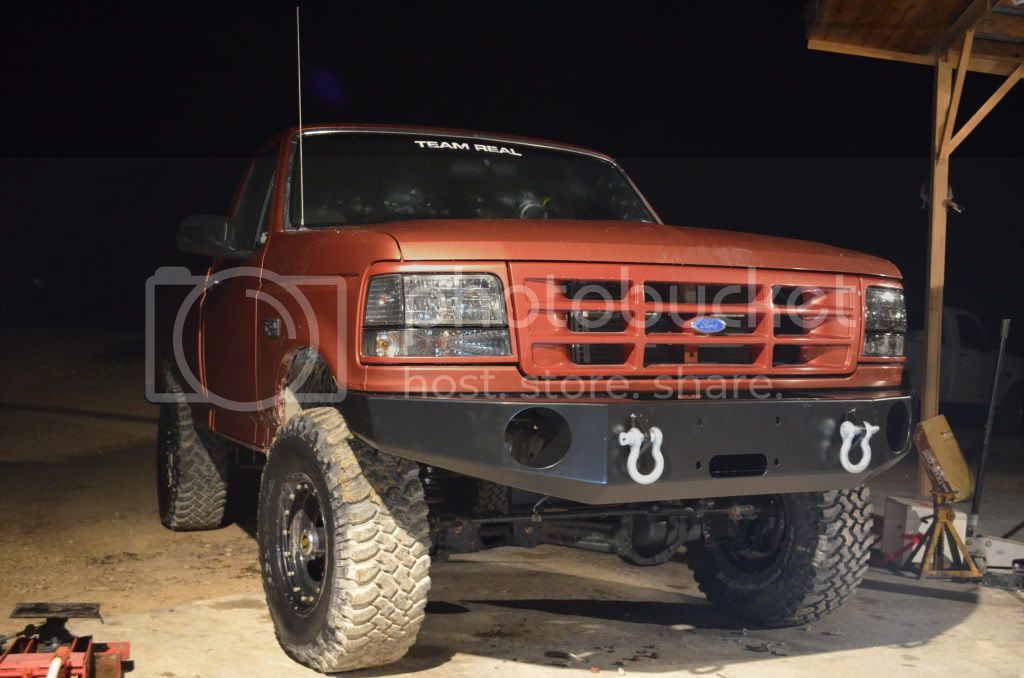

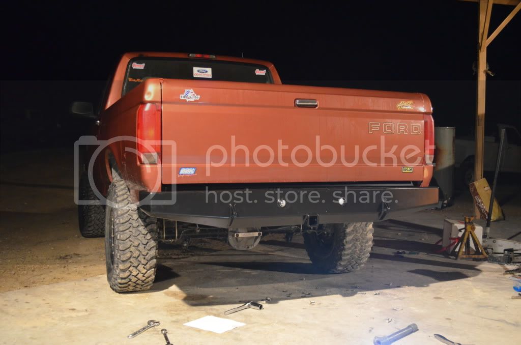

I've also been looking around for ideas to build my own off of. This is one complete performance used to offer but I think something happened with their supplier but it's probably the concept im going to start mine with.
FrankTheTank
Oct 15, 2011
1,339
Cecil County, MD
That one from CP is an awesome looking bumper... i like the pre runner style
I think u can still get something almost just like that from buckstop, just a little more cash

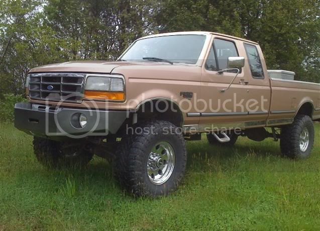

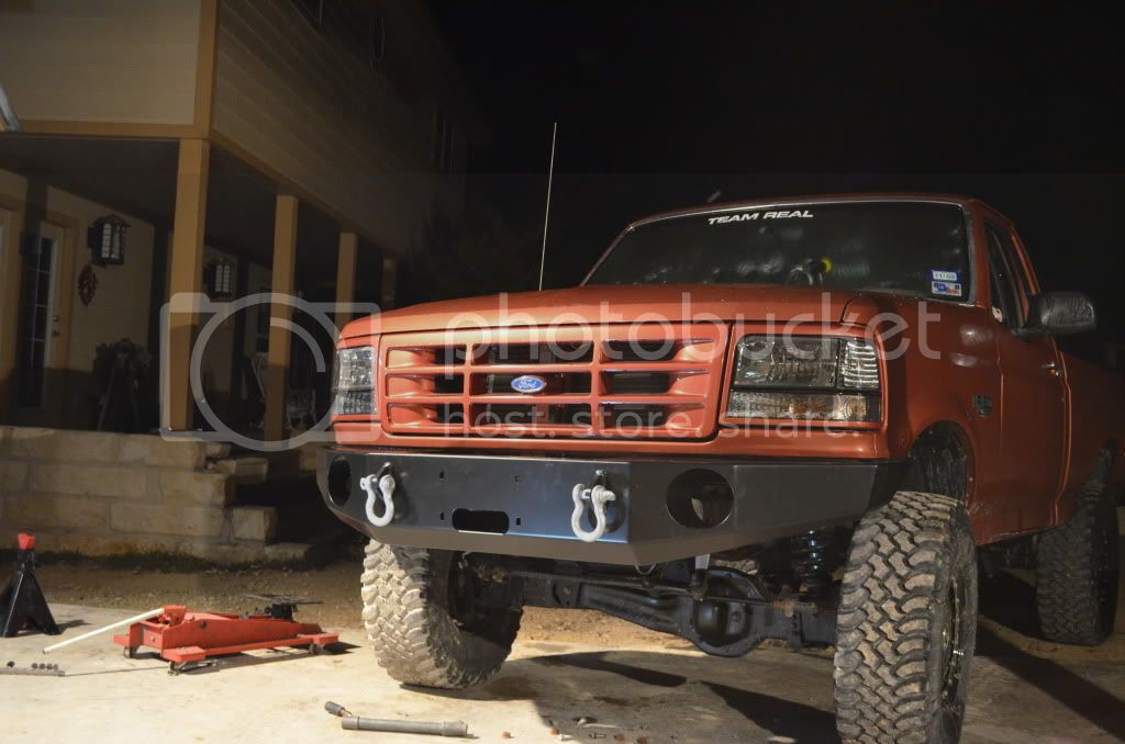

heres my version of the CP diy bumpers, just made lots of cardboard templates and went with the ones that looked the best and got 3/16 bent up :evil

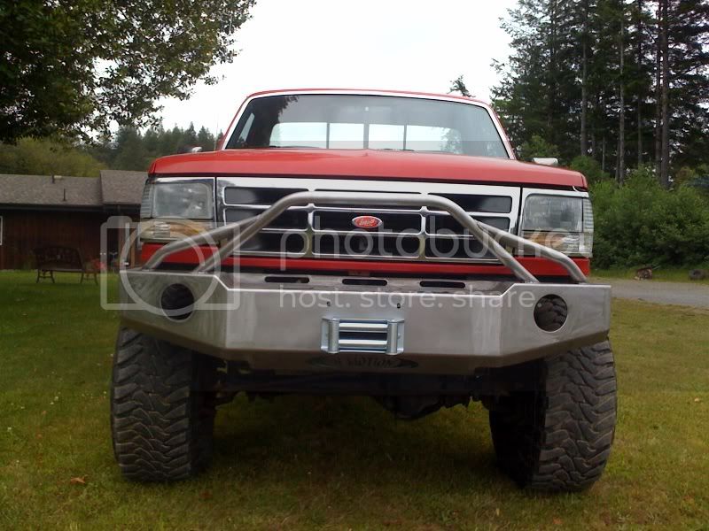

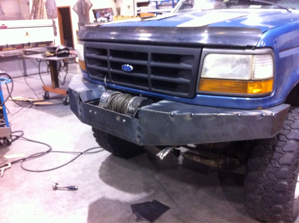

Me and my buddy built this one for his truck ... I'm gunna build one like it to replace mine ... Little beefier then the last one I did
