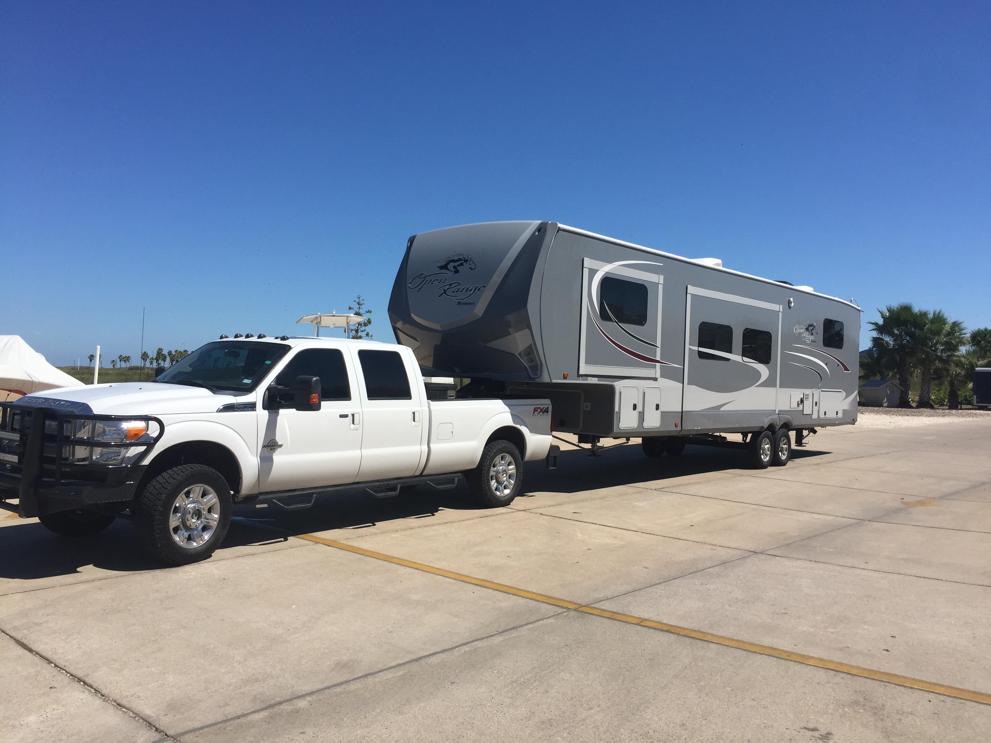

Not a perfect angle but gives you an idea of how it sits with the trailer. I have 4" blocks with the factory style bumpstop tang and thought about going back down to stock 3 5/8" but only saving 3/8" so not sure it is worth the effort and I have 2" springs in the front so if I went any lower than stock I'd be replacing front springs too. Not in the market to raise the trailer.

Doesn't look too bad. The rear of the trailer looks about 2 inches lower than the front. Only way to get it perfectly level is to raise the trailer or lower the truck by swapping to F250 springs & blocks. If you lowered the 5th wheel height, you'd be too close to bed rails.

What he said. I'd just add the bags to level it and see how you like it. They're "used" now so you may as well install them and see what happens. Then sell them to me. Brian is way north of me. I'm just a bit north of SA. LOL.
