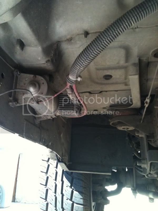

Not sure what your spare tire size is but if it is not usable any more, mount the compressor and tank where the spare tire sat. That is where mine is going when I do this mod.

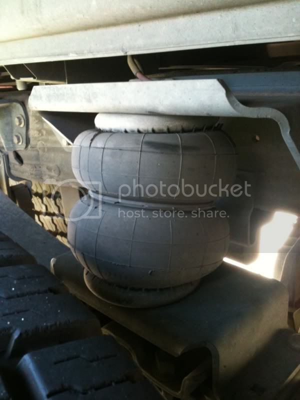

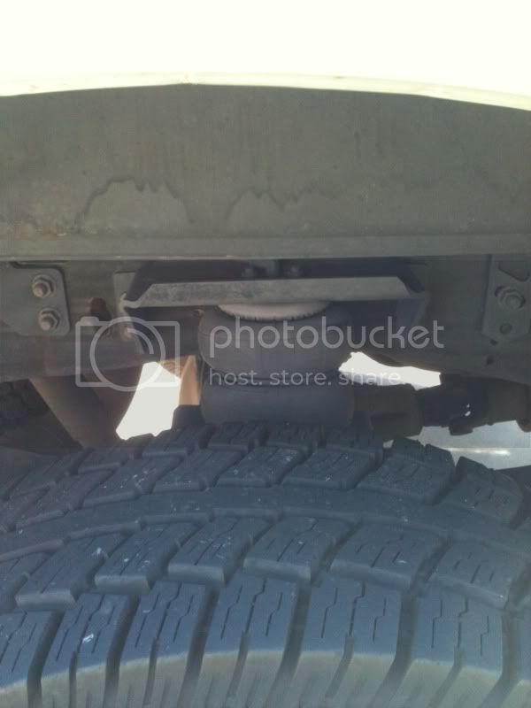

If I were going to do an airbag setup, I would do those new firestones that replace the rear springs. It looks bad ass.

Jbone i like ur setup i might be doing something similar to yours. The spare also seems like a good idea but im not sure if i want to loose my spare in case of an emergency.

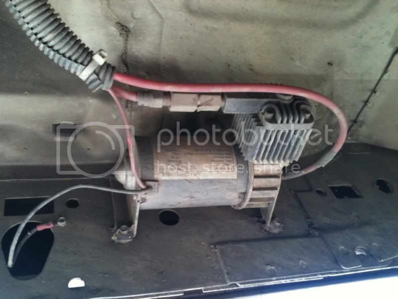

Does it matter if the compressor is open to the elements?
Well mine has been on the truck for about 6 years and I haven't had any issues. The compressors are pretty durable. I guess if you wanted you could fabricate a box to go around it.

I use the Firestone bag kit like the poster's before, but I flipped the frame bracket to work with my 5" lift springs.
I mounted my compressors to the outside of the frame rail under the passenger side door. The air tank is mounted on a custom bracket under the bed in front of the passenger side rear tire. The air horns are on the driver's side under the bed in front of the rear tire. I have a longbox though.

Do you have any issues with the compressor or the filtration of it, getting covered in ice/snow or anything else coming off of the front tire?

I'm looking at the Firestone j link set up. Much bigger bags with a very soft spring. Looks like a nice kit and a lot better that the ride rite bags if you are looking for heavy towing that is. Just my opinion
