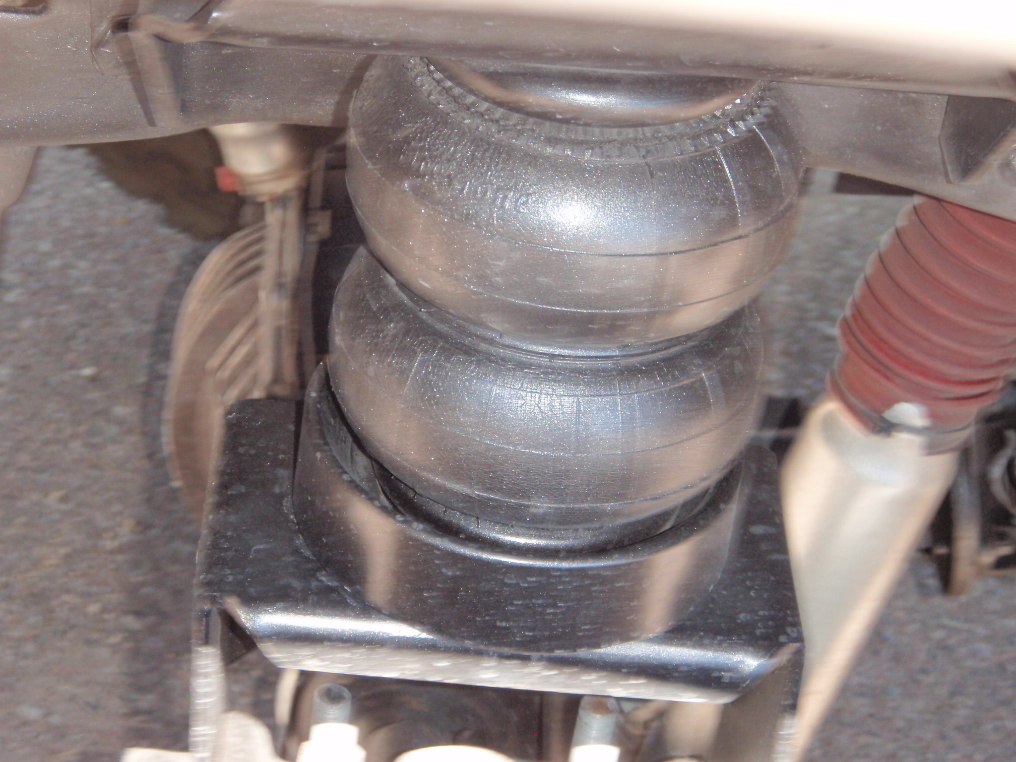

if you go with inboard bags u will need a spacer ( bags sit inside near the leaf spring and mount to the axle )
if you go with outboard bags and u have a lift block with OEM springs u will need nothing ( bags mount to frame and leaf spring )
if it's a spring lift and u go with outboard bags u will need a puck or a modification of some sort ( see my 8 inch lift bags with custom mount and a Daystar cradle ) http://www.youtube.com/watch?v=r4QBG3izhyA
outboard bags are better anyway they control sway a little better and the system is stronger IMHO

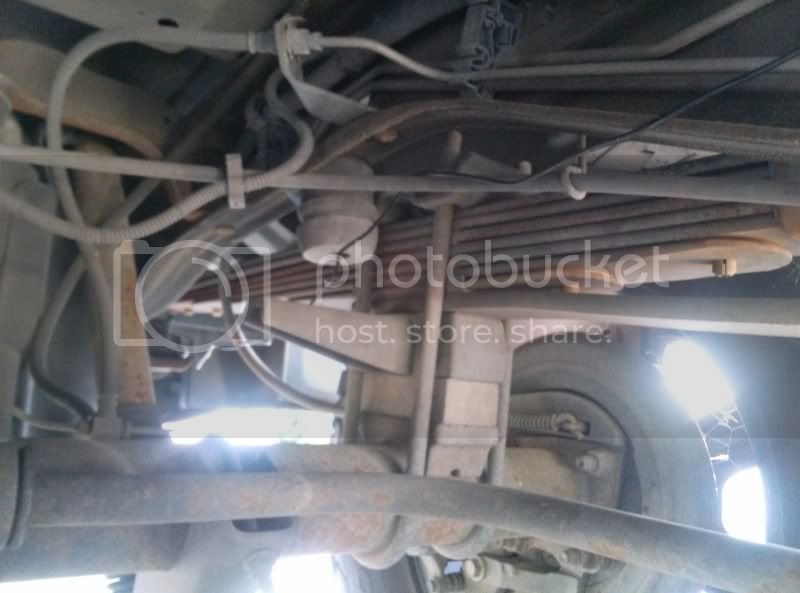

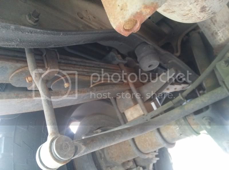

Thanks everyone - looking forward to trying the bags out. I have a ton of tools, so shouldn't be a problem. Also - looks like they just put blocks on it to lift?

also check your bottom blocks they look a little cockeyed
I literally shook my head when I saw them. LOL!!
