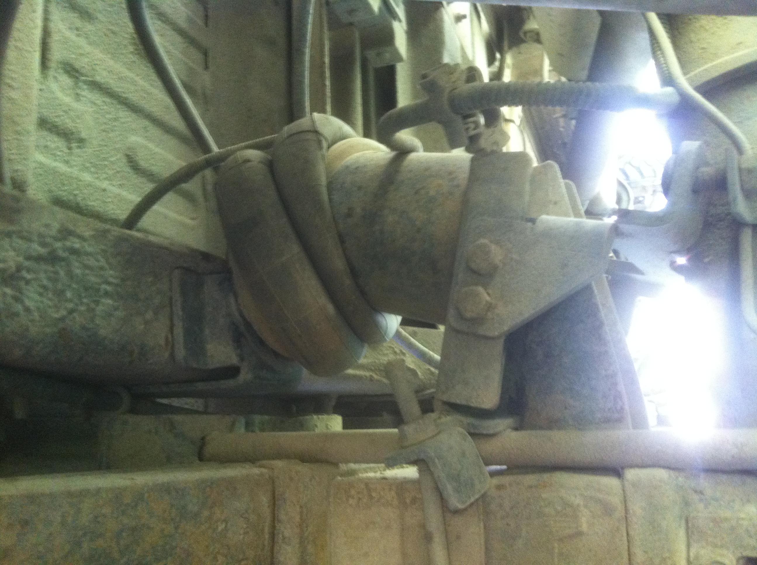

Does anyones air bags look like this after a trip? mine are less than 6 months old and are crap! I think the steel was from a pop can and the bolts well that is another story breaking off while I was trying to align the bags..
So I does anyone have any other bag set up that works? I am to the point of going to a welding shop and doing some reconstructive surgery because all the shops I called said ya sorry for your luck

When i installed mine i put steel plate between the factory bump stop and the bag bracket so it supports it there also. I got the bag bracket in place without the bag. I then drilled the bump stop arm so the hole that mounts the bag holds everything together.

That bumpstop bracket needs to be rotated 180 degrees such that the tab that is against the spring is away from it. The lower bracket will then sit on top of the bumpstop. The someone who installed the kit is a retard.
