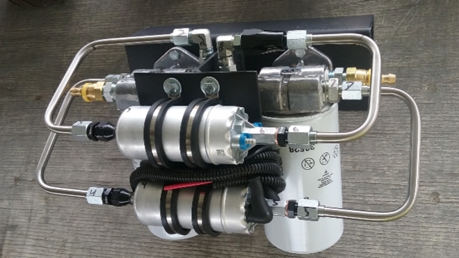

Should have just bought the twin pump kit from 444fab u could buy just the pump and filter part no regulated return.
78-79fordman
Feb 13, 2013
51
Or u could just build it similar to 444fab my 444fab dual kit . I have a feel this is what u will do in the end .
