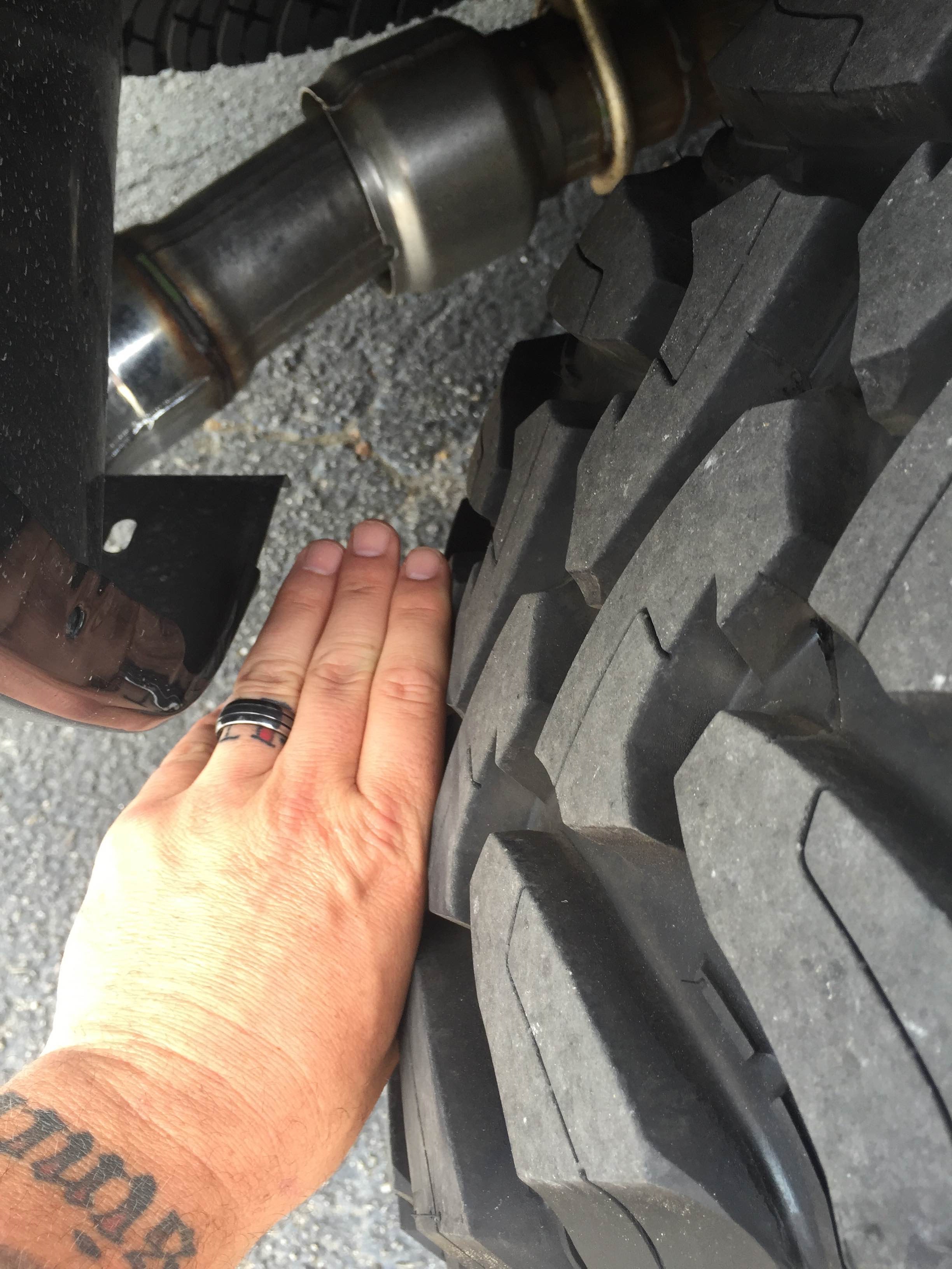

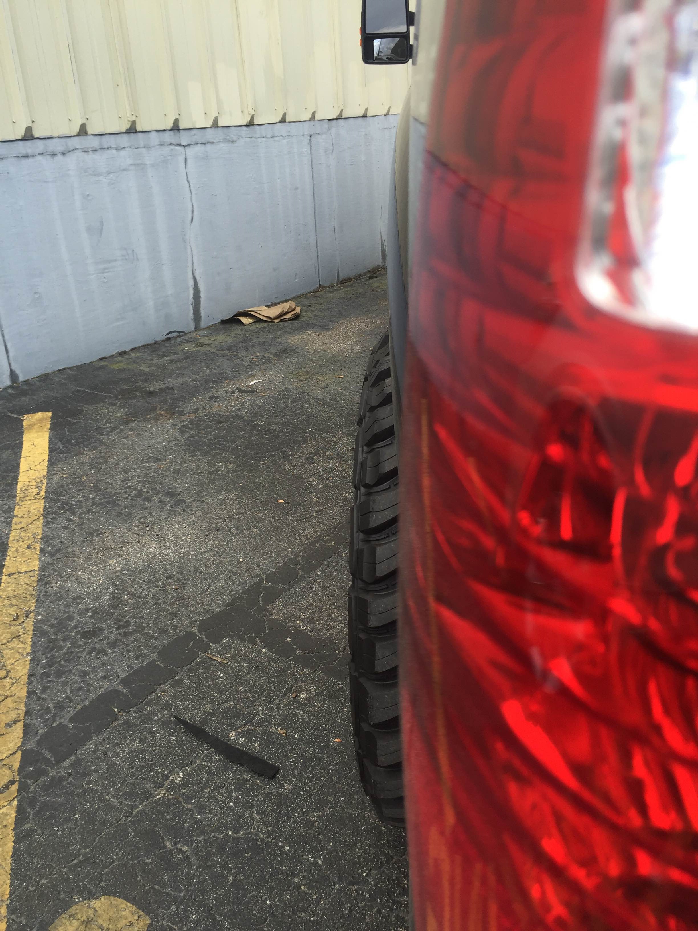

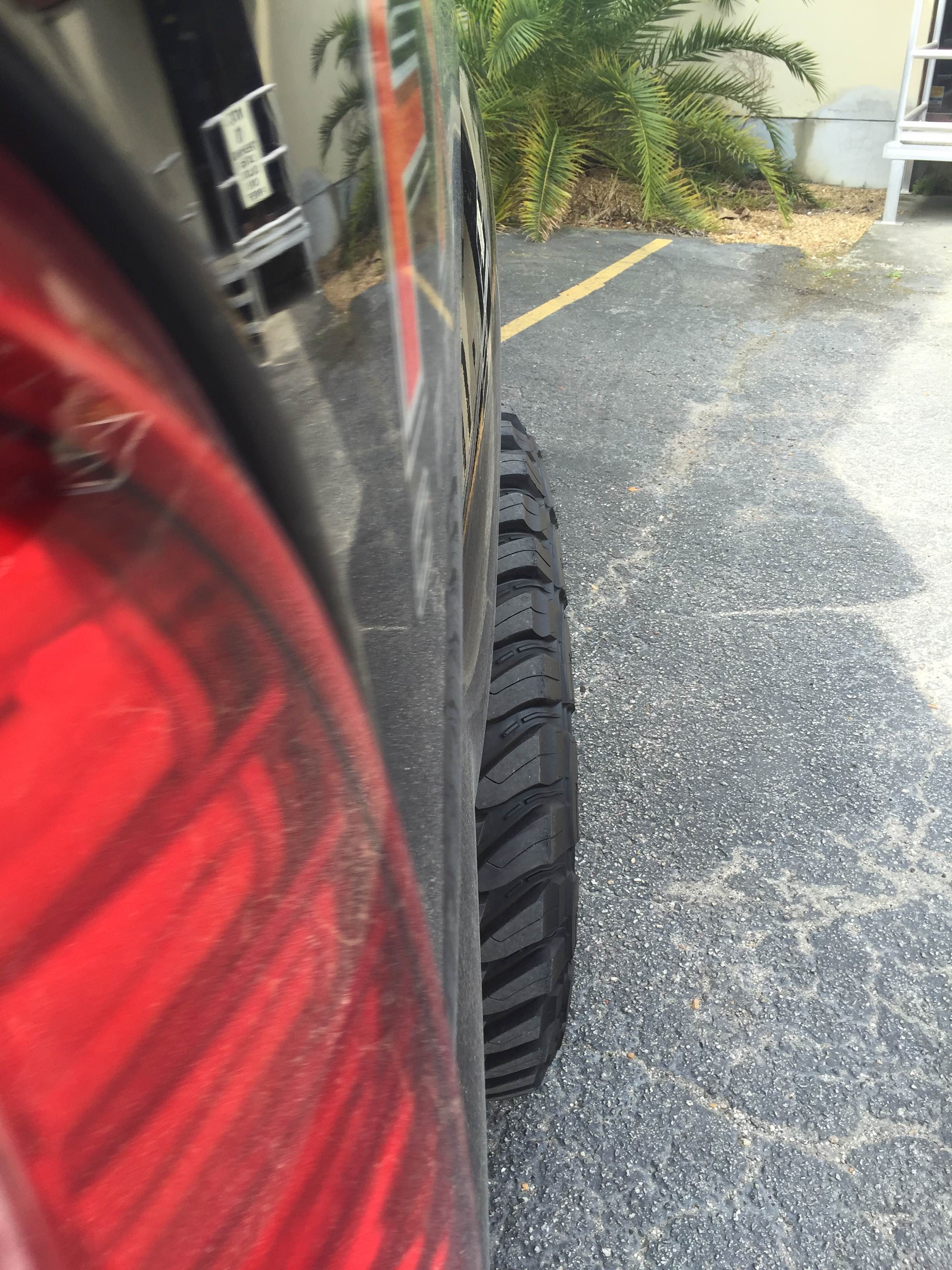

I just got a new 2016 and was wondering why it would be out of alignment? When I get to about 67-70 it starts shaking pretty bad and it cant be from the tires I just put on it. I just put toyo 35x12.5x20 tires on but that cant be the reason the rear end looks out of alignment. If I look at the back of my truck the right rear tire is sticking outside the fender about an inch more than the left side. I also noticed the driver rear tire is closer to the back rear fender than the passenger rear tire??? Dose anyone know why this would be? I do remember it shaking some when I had the stock tires on it also but I only drove on them for about 200 miles.

It is common for tires to be somewhat out of round from the factory.
You have also altered the geometry suspension with the oversize tires.
First, find an aftermarket shop that can also perform alignments. Most shops will just ensure that the truck is with in factory specs, but one must consider that the factory specs were intended for factory equipment.
If the issue persists, go back to the tire dealer.

I would guess the bed is out of alignment which is why you're seeing the difference. As for the shake, probably the tires. Balance, out of round, not mounted right on the rim. I would also measure from the frame to the outside of the tire on both sides. See if the distance is the same within 1/2" to 5/8".

When you get bigger tires it's a common issue that the axles/wheels don't line up. Get an aftermarket track bar to adjust your thrust angle.
