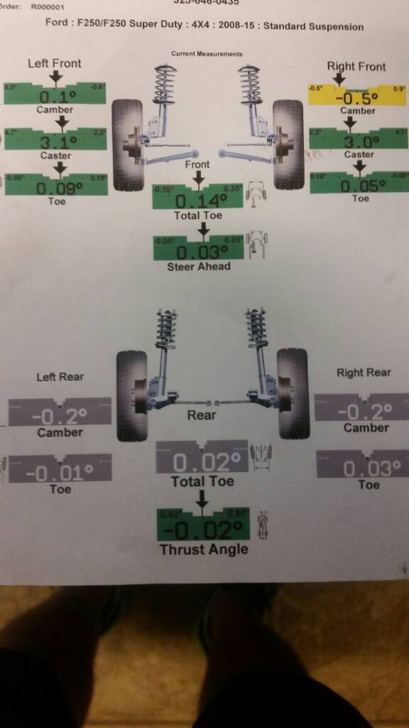

Recently had a 3" Rough Country lift installed on my 2015 f250. I installed an icon adjustable track bar and icon 2.5 reservoir piggyback shocks along with an icon dual steering stabilizer. The only things left from the rough county lift are the three inch coil springs and radius arm drop brackets. Problem I'm having is it's pulling to the right. I had the shop that installed the lift align it. Here's a shot of the alignment.
My question is would the camber being off that little bit make it pull to the right?

Did they change out the camber/ caster bushing on the upper balljoint on the axle? Most places dont want to do it but its the only way to do it right. Expect about a $300 alignment but it will be right.

they did not change that out. they seem to think that since it's close enough to spec, it doesn't need it. the way i see it, thats the only thing out of alignment, albeit just a small amount, so to me it's whats causing the truck to pull to the right.

and could somebody correct me if i'm wrong, but don't the stock camber bushings have about .4 degrees of adjustment?

pull didn't start till after the lift. had the wheels and tires installed before the lift.

So would that little bit of camber on the passenger side make it pull that way? The alignment shop seems to think that wouldn't make it pull

Im still saying its the camber caster bushings. When lifted my 06 i took it to 3 different places and they finally got it right and had changed them out. My 2010 i lowered and took them 2 times and same deal swapped them out. Spc make a few different degrees and they are non adjustable. You just have to swap one then check it on the machine. And keep doing it till its right. Its a big pain thats why most places wont do it or just say its fine live with it.

227
