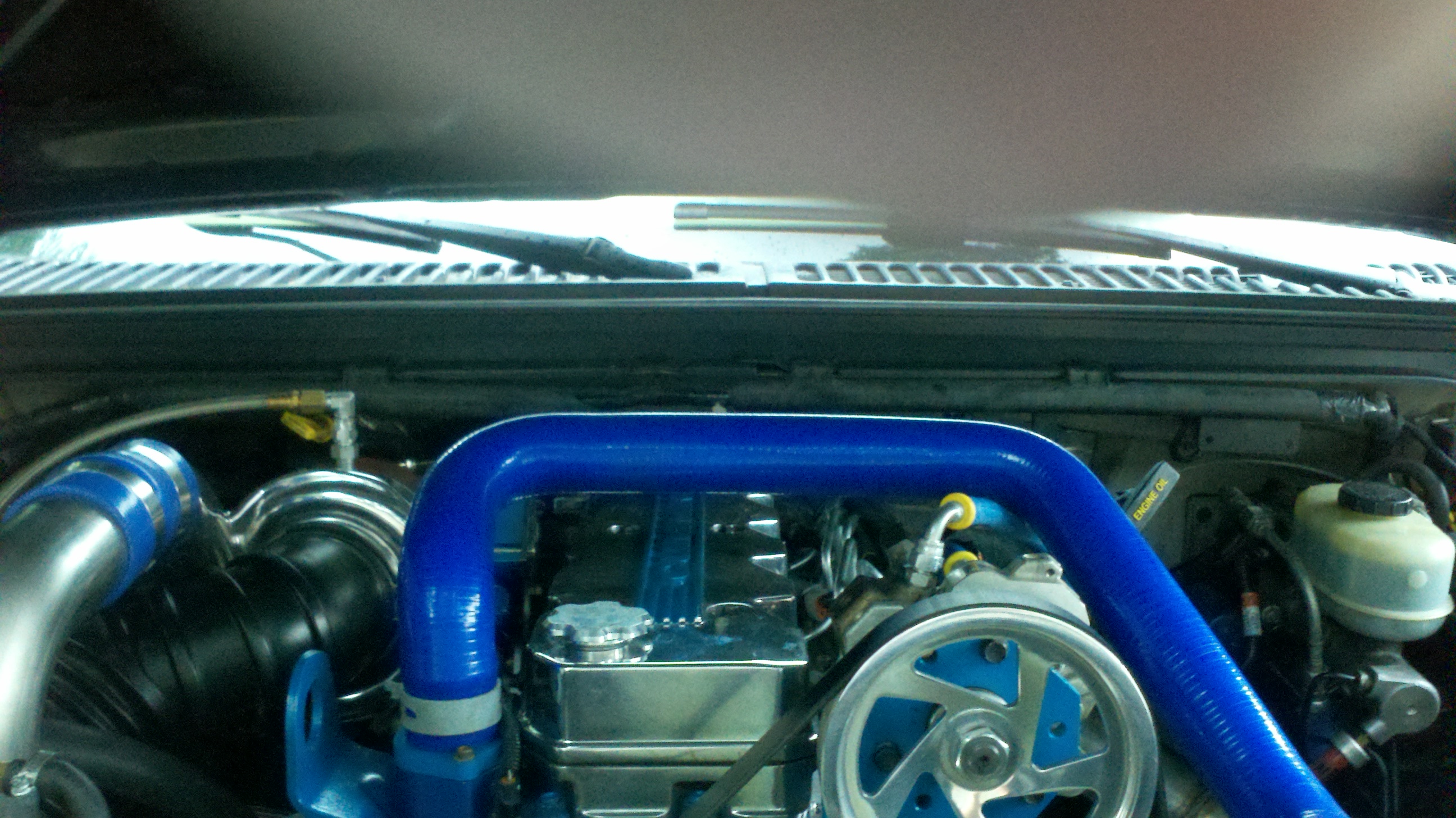

I used Destroked mounts and slotted my trans crossmember. It was more on the passenger side

Well I got off my ass and started doing a little measuring, I shoved my motor as far back as possible then moved my passenger mount back and Im probably going to move my driver side up which will center it as best as possible. I'm gonna have to figure out my crossmember issues
