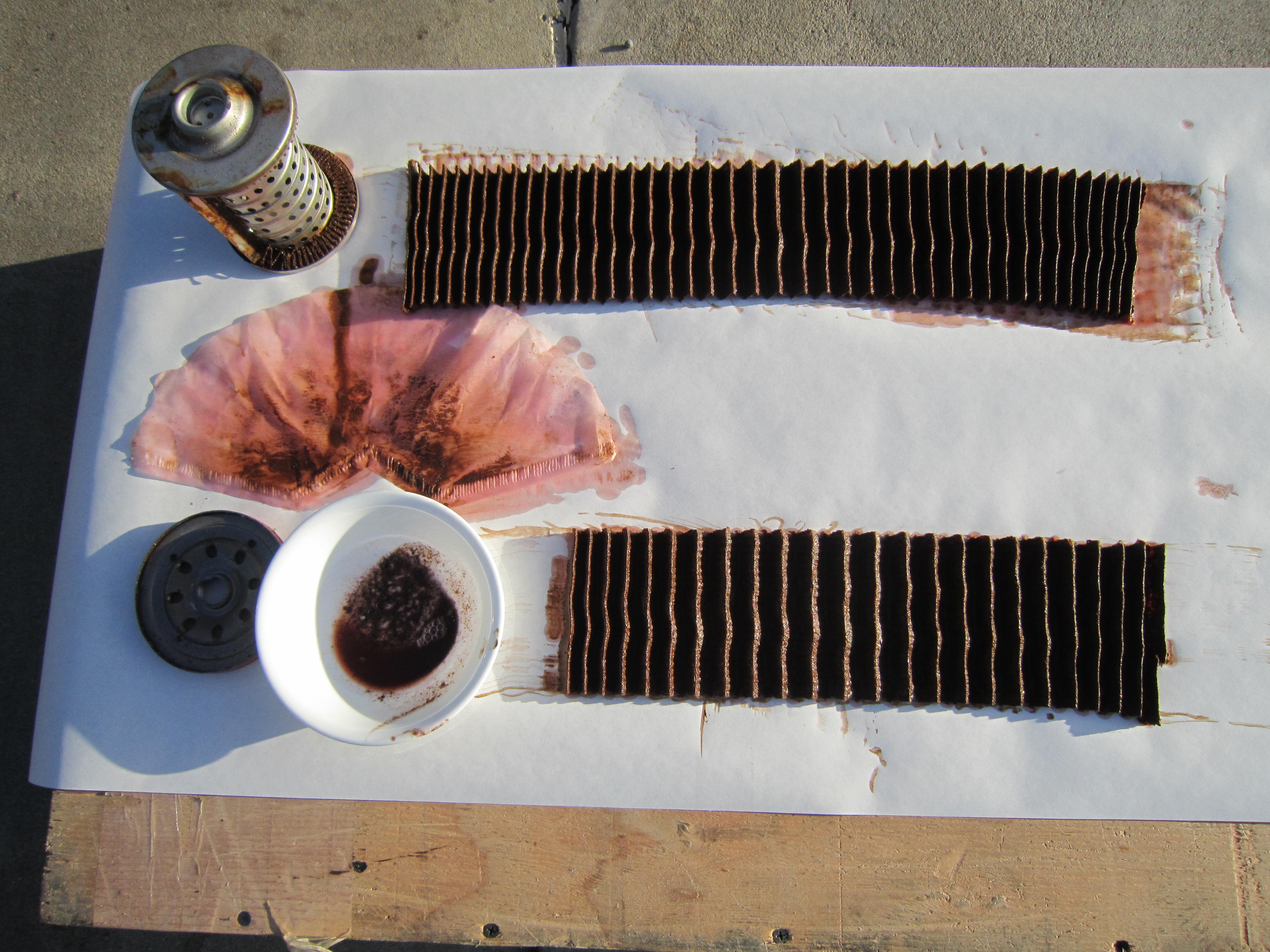

221,698 miles on the truck, 2005 miles after the Delo ELC was added after a Restore and Restore+ flush. What was in the filter was strained through a coffee filter, and the last little bit was dumped in the white bowl. This casting sand has been circulating through the engine for over 4600 hours. Can there be any doubt about the need for a coolant filter?

Sorry 7.3 owners. I intended to post this to the 6.0 aftermarket forum, but clicked here in error. Still, what's in your engine?
